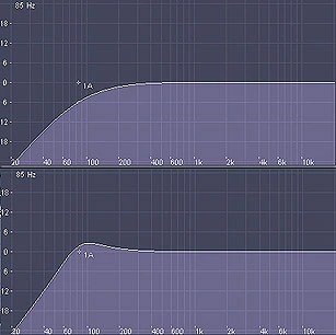

It's real and I've read the explantion -damned if I remenber though.
There is the hump you get at the rotation point on steep filters, maybe it's there to a lesser degree on all of them.
I'm familiar with this on low/high pass filters, I don't know if I've seen it on parametric or notch filters though.
Below is an example: Both plots show the same high pass filter (plug-in) set to the same knee frequency of 85Hz. The top plot has a Q setting of 0.5. The bottom a Q setting of 1.25. Note the "bump" that mixsit is talking about actually is boosting the signal by about 3dB at 100Hz.
