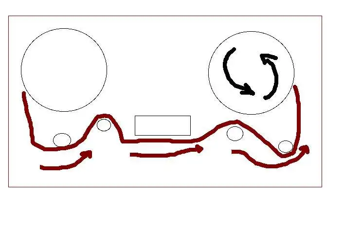

First of all, with no tape placed yet, only right reel moved (counterclockwise) and something was loose inside, I've opened it and placed the belt (is this the name?) from the engine to the left reel.
Once closed, both reels move, but the situation is as follows:

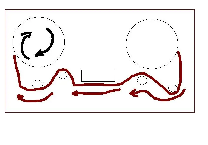

When I rewind the tape, left reel moves clockwise and rewinds the tape:
rew.webp​
Good.
When I press the FFWD button, right reel moves counterclockwise and works as expected:
ff.webp​
Brilliant.

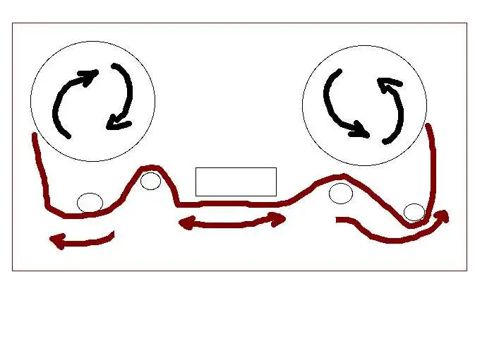

But when I click on PLAY, left reel moves clockwise and right reel moves counterclockwise, the tape is pulled from both sides and doesn't move:
play.webp​
I don't know if it's the normal operation (I imagine it is NOT, but...) and I'm doing something wrong.

I don't know much about the R8, but in the Revox B77, if you force it to run empty, it does indeed try to turn both reels in opposing directions like that, which I believe is how it keeps tension on the tape.
Now, missing from the diagram but to the right of the head cover there should be two small wheels - a metal one (the capstan) and a larger, rubber-coated one (the pinch roller). This is actually what pulls the tape. Firstly, check whether the tape is threaded correctly - it needs to go between the capstan and the pinch roller.
Then, make sure that the capstan is turning - I can't remember from my old A8 whether it spins continuously or only when tape is loaded. If it isn't turning, you have a problem. This could be mechanical (the belt has come off), electronic (the sensor has failed - usually on the right tension lever) or serious (the motor has died).

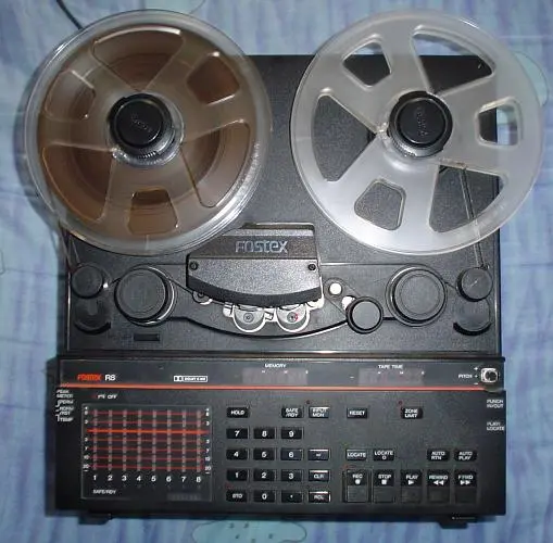

The tape is placed as in the manual, as in this picture:
from chookfest.net/emil/gear/r8.html​
I don't have the machine here right now, but... I would say the capstan didn't turn... wow, bad news. The pinch roller turned freely, easily, but I'm not so sure about the capstan, I think it was stuck. I'll check tomorrow.:(
I understand capstan is A and pinch roller is B.​
I would say there was somehow a bigger than desirable resistance when PLAY was pressed against making the reels and the tape move manually, probably coming from the capstan+pinch roller.
