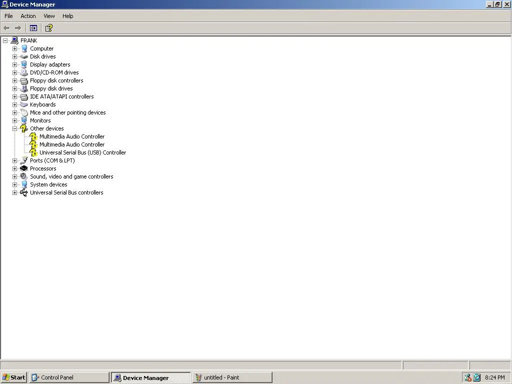

this is what my device manager looks like

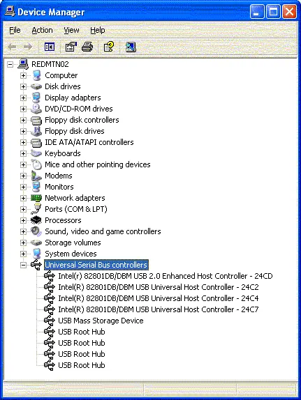

Go to Start>Control Panel>System>Hardware>Device Manager. Expand the USB tab. You should see something similar to the attachment. Send your picture back.
