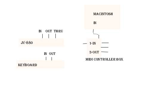

Ok, Here goes:
Here's the set up:
The computer program is called Vision. It has a setting where you can put it in record/hold, and when a note is struck, the recording begins.
I was able to get it to record what I play on the keyboard, but I can't hear the drums, which are in the JV -800. I should be able to:
1. strike a key on the keyboard, which triggers a corresponding sound in the JV 880 (AKA a drum sound)
2. that key strike should also trigger the recording to begin in the Mac, so that upon playback, I can hear what I have recorded.
So far, I can either hear the drums when I hit the keys, or I can record the keystrokes without hearing the drum sounds, but I can't do both at the same time. When I hit playback, I can hear the drums but since I could not hear them during recording, well, it's like trying to record something without hearing what you are recording.
Hope that explanation works.
Bushice
Chris,
I think I have it figured out. I needed to go OUT of the KYBD, to IN on the JV-880, from THRU of the JV 880, to IN of the midi controller.
That made it possible.
Actually, thanks for asking those questions. It gave me the idea of what to try :)
bushice
