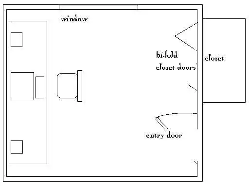

John. Based on the picture I have included, can you make some accoustic treatment recommendations? Is the closet (which is to my back when mixing) going to cause some problems??
well if you filled the closet with clothes it would act like a bass trap which would be advantageous. :) Keep the doors open or take them off completely.
cheers
JOhn
John. There are no clothes in the closet. I store guitar cases and some computer equipment in there. Do I have any other alternatives?? If I were to construct a bass trap, where would it have to go?
