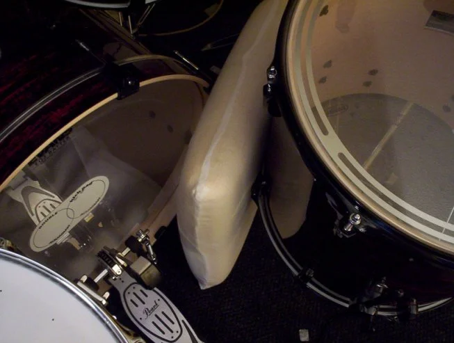

Rather than attempting to mute the floor tom reso head, (which makes the drum sound dead,) I attempt to reduce the amount of energy reaching the floor tom.
This is one of those very dense memory foam pillows. Just don't allow it to touch either drum head.

That's interesting. Never seen that done before

RD- ill give that a try and see how that goes, but when i start getting into and the drums start moving wouldnt it just fall out of place?
