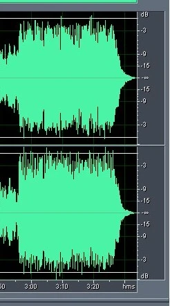

here's the end of the song..but hopefully a better "close up"... and a good reflection of the rest of the song too.

This mix is definately leaning to the right and my eyeballs are telling me the same thing.
Respectfully (and definitely NOT wanting to turn this into a forum thing ;) ) my eyes and ears are telling me something quite different.
Yes, there are time when the balance shifts right. There are also times when it shifts left. It's a dynamic mix in that regard (which I like), but overall, the dynamics average out pretty centered. That's how I hear it as a whole production.
And, frankly the numbers and the eyes back that up. Here is a series of screenshots that I montaged using Sound Forge and Elemental Audio's Inspector as the analysis tools. I could have also included a few other analysis tools that I looked at and back this all up, too, but this should be nough to illustrate the point.
The top screenshot shows the overall measurements for the whole song, broken down by channel. I highlighted the RMS energy measurements, which not only are virtually even between the two channels, but actually give a very slight advantage to the left channel. That advantage of one tenth of a dB is negligable, of coursse, but it does show that any bias towards the right would be a localized efect and not part of the overall character of the song.
Below that show four different ~3-4 second slices of the song that I picked semi-randomly. Random in every way other than I purposely tried picking generally representative spots; the first where the majority production arrangement steps in (intentionally after the parts where mostly all that's there is the vocal and the Rhodes, all on the left), two from different verses where the full arrangement is going, and one during the final intermissiive.
I let the chips fall where they may as far as measurements went; i.e. I did not purposely pick spots that I thought specifically backed me up; I just highlighted some spots quickly, ran the tests, and printed them, letting the numbers tell their own story.
Each test segment is highlighted on the waveform. The three sets of numbers indicate the start/stop position of the sample, and the sample's total length in seconds. Then there is the blue/red L/R energy distibution/balance meter showing the actual left/right balance during that segment, and then a set of dBFS meters for that segment. The thin outside meters indicate the RMS levels.
Notice that all four segments are fairly close to centered. Any dynamic mix will of course bounce around, but should usually hover pretty close to center. That's just what's happening here. Samples 2 and 3 do show a bit of a lean to the right, sure, but not a lot. Besides, samples 1 and 4 show similar leans to the left, indicating the overall truth that there really is not a preference to left or right in the song overall. Note also that two of the four RMS readings slightly weigh left, one slightly weighs right, and one is practically a dead heat. Yet more parity in the numbers.

But looking at your SF files, they seem dominant, volume wize, too.. (on the right) just like my Adobe .wav file screen shots. Not by much, but by that little bit.
But in the end, I'm confident you use your ears and could just put tape over any meters anyway.... Just like I would hope to do also.
But, THIS example helps me make sure my "system" isn't off kilter too. I have something to compare against.

I DO think your choices of picking the .wav files were poor. Look at the VERY last section after the break (starting around the 3 min mark to the end of the song). That entire section of the .wav file is clearly "louder" in the right, as the .wav file is noticeably larger in that channel. Sections of dominate keys will be the opposite, since they are postitioned, primary to the left. (as seen in your other choices...either random or not).
Anyrate, again I trust my ears, and was initially worried my system was skewed to one side, but am confirming it isn't. I think all your "golden ear" friends are deaf on one side!! :laughings: :laughings:

Well, I guess one of the lessons others can gain from this is how one cannot tell as much as they think they can from looking at a waveform timeline display, any more than they can by looking at an FFT, especially when the waveform display is zoomed out as far as both of us did with our respective editors. When all the waves get bunched together into solid shapes because of the zoom factor, it can lead to misleading inferences. Rememeber those are not really solid shapes, but rather a single, one-dimensional line.
The right side is going to look louder under those conditions, even if everything else is equal, simply from the preponderance of snare and hi hat peaks on that side. Yet, when one actually performs a real analysis on the waveform in the form of left/right energy distribution and RMS measurements, one sees that areas like the end of that break that so "obviously" look tilted to the right, are in fact, not.
Check out the "Zero crossings" measurement for the entire song at the top of the graphic I posted. That is the only stat that is weighted to the right. That's because that's where the preponderance of percussive AC transients are located. That's what's making that right waveform look slightly fatter. Yet the RMS for the whole song is basically a dead heat between the channels, with actually a (very) slight advantage given to the left side.
