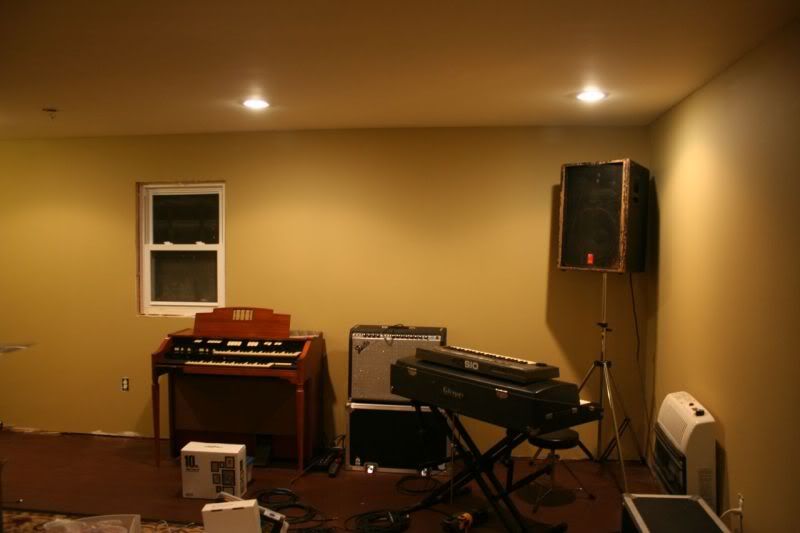

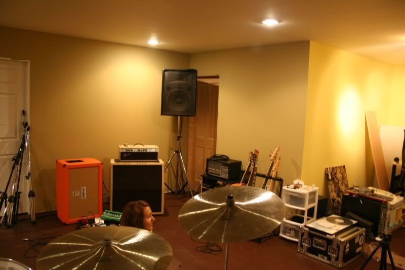

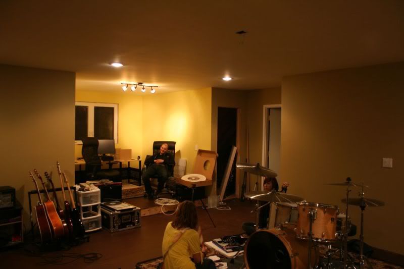

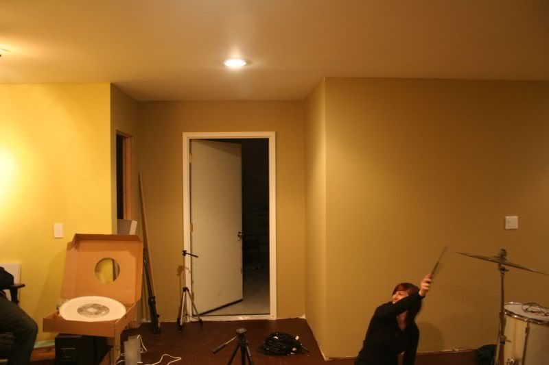

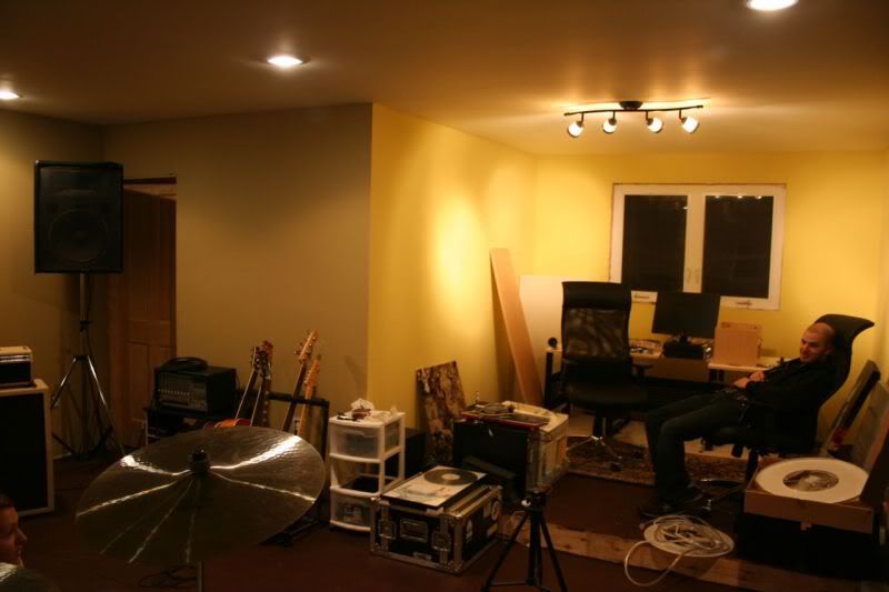

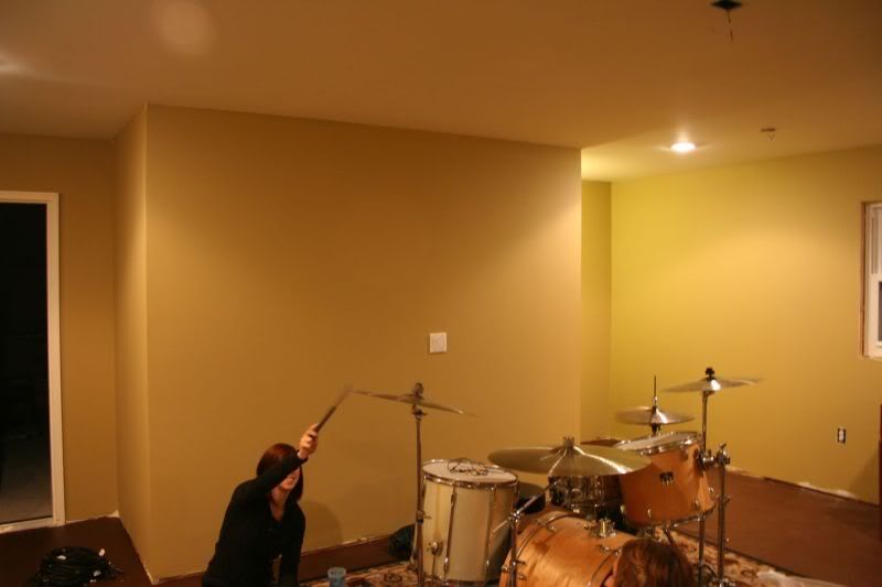

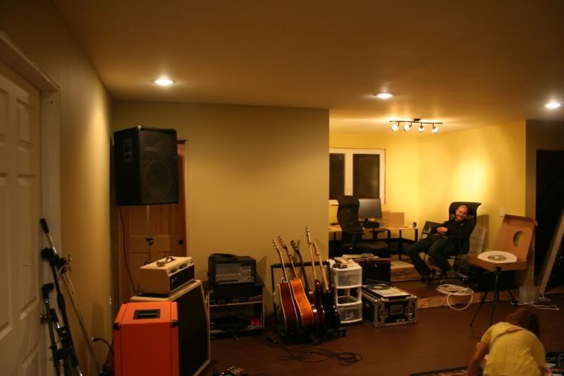

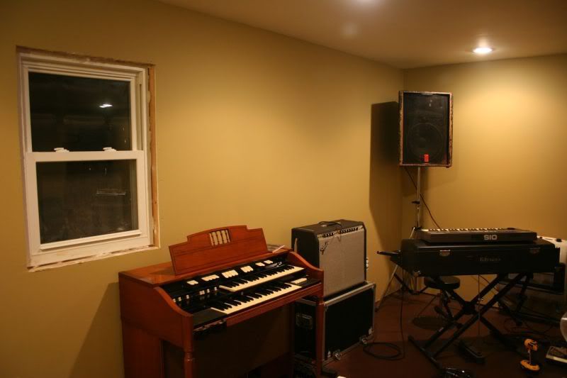

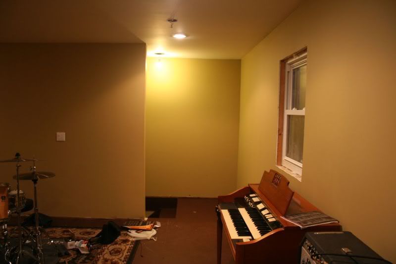

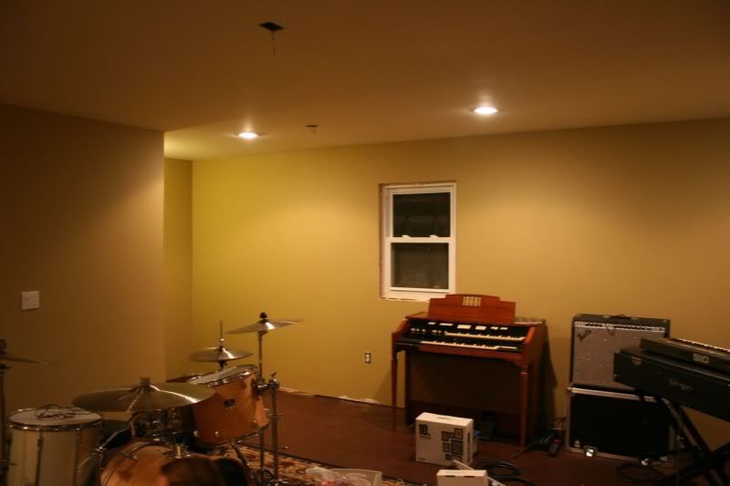

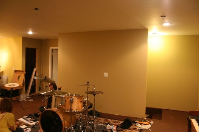

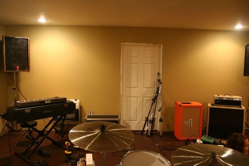

I just moved all the gear into my new studio and im weighing out all my options for acoustic treatment. Ive been referred to ATS acoustics and i was planning on building my own versions of there 2x4 and 2x2 panels with owens corning 703. The general dimensions of the room are 21x17 with 9 foot ceilings. I plan on primarily using it to record alternative/rock music. The side room with the 2 chairs is going to be the mixing area and i plan on keeping it open like that an hanging moving blankets or something for isolation when were tracking drums. Any suggestions or opinions on my situation would really be appreciated. Thanks in advance!
