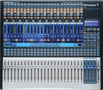

have you seen the Presonus StudioLive 24.4.2?
If I had $3,300 to spend....this would be it. The Presonus StudioLive 24.4.2. 24 preamps, one firewire cable running into your laptop/desktop, press "arm all tracks" in the software and record. It doesn't get much easier than that.
I should wipe the drool off my keyboard now.:o:o :D

dastrick: Thanks for pointing that out. I'd been on their website under "recording" so didn't notice that monster. It appears to only be located when you view all products "by name".
That looks awesome, particularly because it could be used for live (it's purpose) but does that count as a "preamp" or any of that fancy jazz that so many people insist on putting between a vocalist and the DAW? Specifically, (foregoing personal preferences?) could I drop that on a desk, hook it up to Logic or some such, plug in mics, and have enough to get great sounding recordings, assuming I'm in a studio environment?
Of course, I'd flatten all the EQs, remove effects, etc, before recording to DAW... =)
Yup, that Studiolive would do everything you want it to and a bit more, which is why I would suggest it might be a bit of an overkill for your needs (and cost you a lot more in the process)... I certainly know it would be a waste if I got one, as I would just do as you said and ignore all the mixer aspect of it, keep all effects/EQ bypassed and just use it as an interface. Depends if you would ever use it in a live situation or need the mixer aspect... might make setting up monitor mixes a bit easier/quicker, though that doesn't mean you couldn't achieve exactly the same thing with some interfaces.
