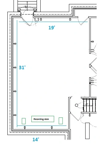

I finished building my basement. The floors are Bamboo hardwood and the walls are sheetrock. The ceiling is 9' tall.
I am looking for ideas/design to dampen the echo in the room. I will probably get the acoustic foam from thefoamfactory.com but not sure which exact foam to get the placement of the foam.
Would appreciate any design ideas.

I went with GIK Acoustics,,, They gave me suggestions, and I worked within my budget. So I can actually improve a bit at a time, with reference and a plan.
Send them a copy of your room info. You can create a free account and create and save your room using their Roomle page.
Here's my Roomle plan. Roomle Planner
It doesn't show the 2 Bass Traps with their reflex technology behind me.
Your room is similar to mine. Because of the space we actually will have a better go than most, dealing with lower frequencies.
My room has good translation, and can still be improved. I'm not using Acr2 or Sonarworks Reference 4, though I have them and their required mics. I use their mic(s) to set up, but used REW software.
You'll want a decent omni-directional mic with its Calibration. Then just use your interface, level and response match the monitors, then grab some frequency graphs of your room. GIK can help you with this also I believe. They are really an all out, top service, in my opinion. They assess and discuss then gave me an update to my Roomle, using my prior purchased Treatments with new placements for this new house studio. I am adding as I go because it is larger. Using GOBO treatments we can put them anywhere needed at any time. I move the rear ones to record sometimes.
I find in hindsight having GIK acoustics follow me from place to place invaluable. I learned quit a bit before contacting them to begin with a few years ago. So I felt very comfortable knowing they were giving the best of options. I spent about $900 on the old house studio treatment. 10'1" x 16' x 8'2" and it translated so well. Very comfortable listening position, not cramped and confining.
THis new room is a little more lively, but a very good listening position with this setup. I was happy with the low end in this larger area, much more workable as I add Corner Traps... Working on the ceiling isolation a bit for now, but it's even rather workable for my situation. Nice surprise, because I thought this room would take a lot just to get started.
Have fun with it,,, It's free, informational and helpful, as well as there in the furture. Most of all it's a successful team to tame and tune a room for audio purposes.
