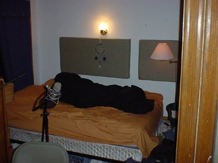

After much revision, my studio setup is finally taking shape. I borrowed a crappy digital camera to take some pictures. The control room (my bedroom) has a very odd shape, so I've tried to treat it as well as possible, keeping in mind that this is a rental unit. The tracking room (my dining room) is a total mess, but I have some pictures of that as well.
Let me know what you think.

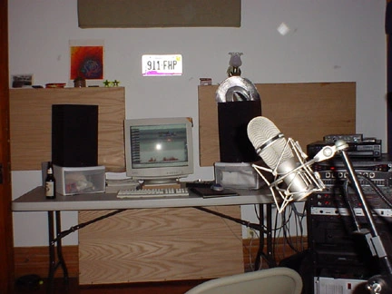

Right side of control room

Left wall. Pretty much the same as the right, but with different art....hehe.

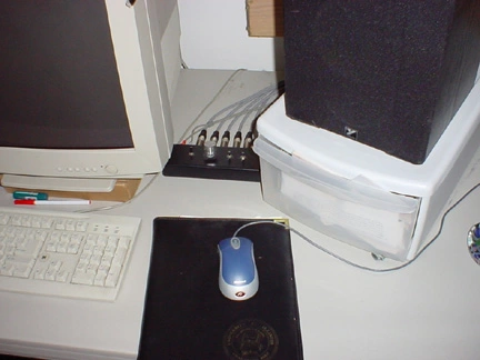

Close up of my DIY volume control/switch box.

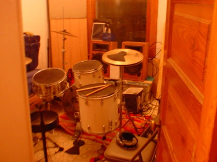

Drum room from other side.

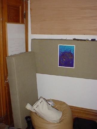

Anyway, it is an ordinary room, or two ordinary rooms rather. They are not sheets of plywood, but instead bass traps similar to Ethan's design. Back side is 3/4" ply, sides are 1x4's or 1x6's and front is 1/4" ply. There is a piece of 1" 703 suspended inside. And they aren't stuck up in random places exactly either - although they aren't necessarily placed in an ideal arrangement. But besides those details your description is perfect.
