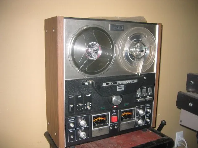

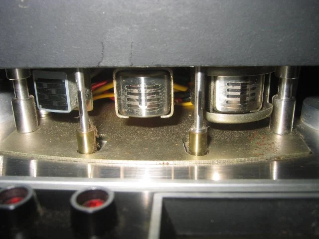

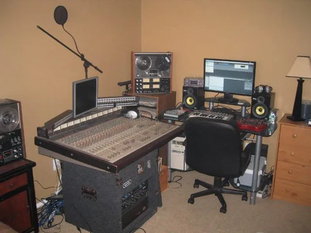

Heres about the best shot of the heads I could come up with... they are super dirty I'm going to get on that right now too. Also a shot of the a-2340 in it's temporary spot in my studio, until I work something else out, and the two track akai machine which was basically free with the purchase of some old tape

Man, real cool setup. :)
That's an M-520 mixer and KRK monitors that I see!:D
The TEAC heads look to have a bit of wear, pretty even from what I can see but they're certainly not worn out. The AKAI is pretty cool 'cause the GX heads don't wear and you can use it for tape delay, among other things. :)
Thanks! it's slowly getting there... getting to the point where I'm going to need a much bigger and more dedicated room, I've been toying with the idea of moving it all into my garage, but if I decide to go that route it's going to be a project and a half;)
Indeed they are, and now that I have multiple tape machines and my digital setup all up and running at the same time, the routing ability of the 520 is really coming in handy. The more complex my studio gets the more I am impressed by the thought that was put in to the design of that board. And those krk's have always impressed me as being quite decent for what they cost.. something a little bigger would be nice but as is I have no reason to upgrade... yet.
Good to have my own diagnosis on the teac heads confirmed! Still being quite inexperienced with the whole analog experience from what your able to see does it look like relapping would be advisable in the near future or do you think it's all right to let them roll as they are for a while?
Ah I was wondering about those heads on the akai, I was pretty amazed by the condition of them so it's no surprise to hear that. It has no problems during playback but I get some distortion out of the left channel when I record. I'm hoping a thorough cleaning of the unit will solve the issue. Then it can function as a bounce machine and I would like to get a delay set up as well but that's going to take some more research as I can't even fathom how to set up the machine for that purpose at the moment, And call me crazy but I really dig those inverse vu meters.
Naa, I don't think a relap is in order, not for a good while. I would just go through the electronic alignment to make up for the wear, you know, things like bias, freq ... those things mentioned in the service manual. No need to go overboard though. That plus the new rubber roller / belt and it should rec / play back fine as is. Dub a favorite CD song onto the TEAC and observe source / tape for the difference. Note that with a modern tape it should sound better yet. :)
