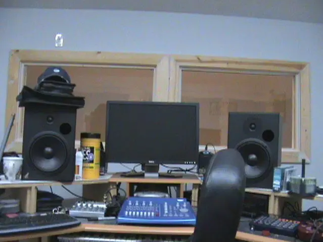

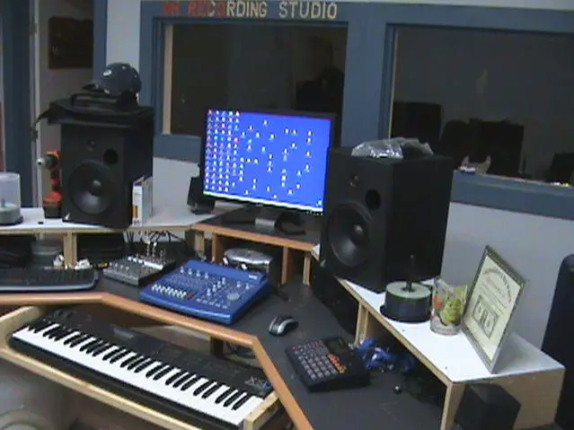

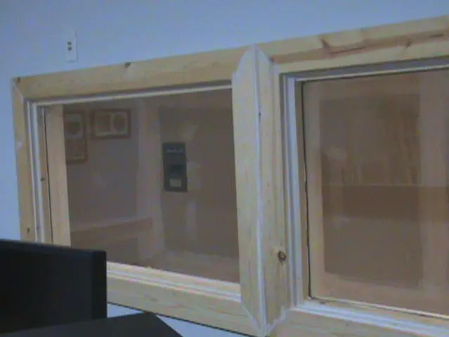

Some pics: pre panels
Here are some pics of the room pre panel. It really stinks it is almost a perfect square- thank God I have plenty of resources to make the panels!!!
