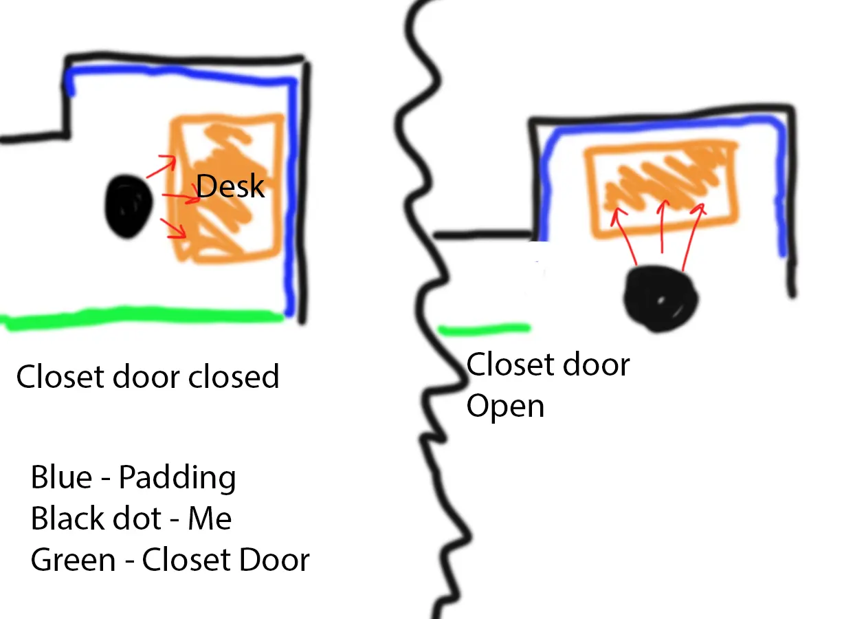

Edit: I was actually going to move to a larger closet this weekend. Its like a half walk-in. I was going to do it as an enclosed space, but I'm wondering if I face the desk so my back faces the door and I just pad the space I'm facing and keep the closet door open in the back would that be better?
I have attached a poorly drawn diagram of the two possible configurations lol

I've done vocals in the bedroom with a double door closet full of clothes behind me. I don't get any reflections from behind, which is in the front of the cardioid pattern, and the drape and bed knocked down a lot of the reflections from the back side. It's way better than when I tried using the living room.
You might try getting one of the Reflexion type filters.
BTW, cats decide what they will allow you to do. A friend of mine has issues with her cats wanting to a) walk across her keyboard, and b) jump into the frame for her Zoom meetings. Eventually, you just realize that you're being allowed to live in their home, not vice versa.
I would vote for trying the setup where you have the open closet behind you. Its contents will help damp anything bouncing around the room that hits that space. Damping in front of you, even a reflection filter, will reduce the energy of that sound before it starts contributing to the other unwanted sounds bouncing around in the room.
Ok I think I've settled on facing the inside of the closet with the door open behind me, but I've bought a clothing rack on amazon where I can drape a large curtain behind me and experiment with the distance away from me to see how open I can sound. Unfortunately I can't do it the other way around because my closet has a weird built in shelf to the side that would prevent me from sitting in the back of the closet facing out. The closet is empty, btw.
An empty closet defeats the purpose, it's the 36" of clothes, towels, etc that break up and absorb the sound reflections.

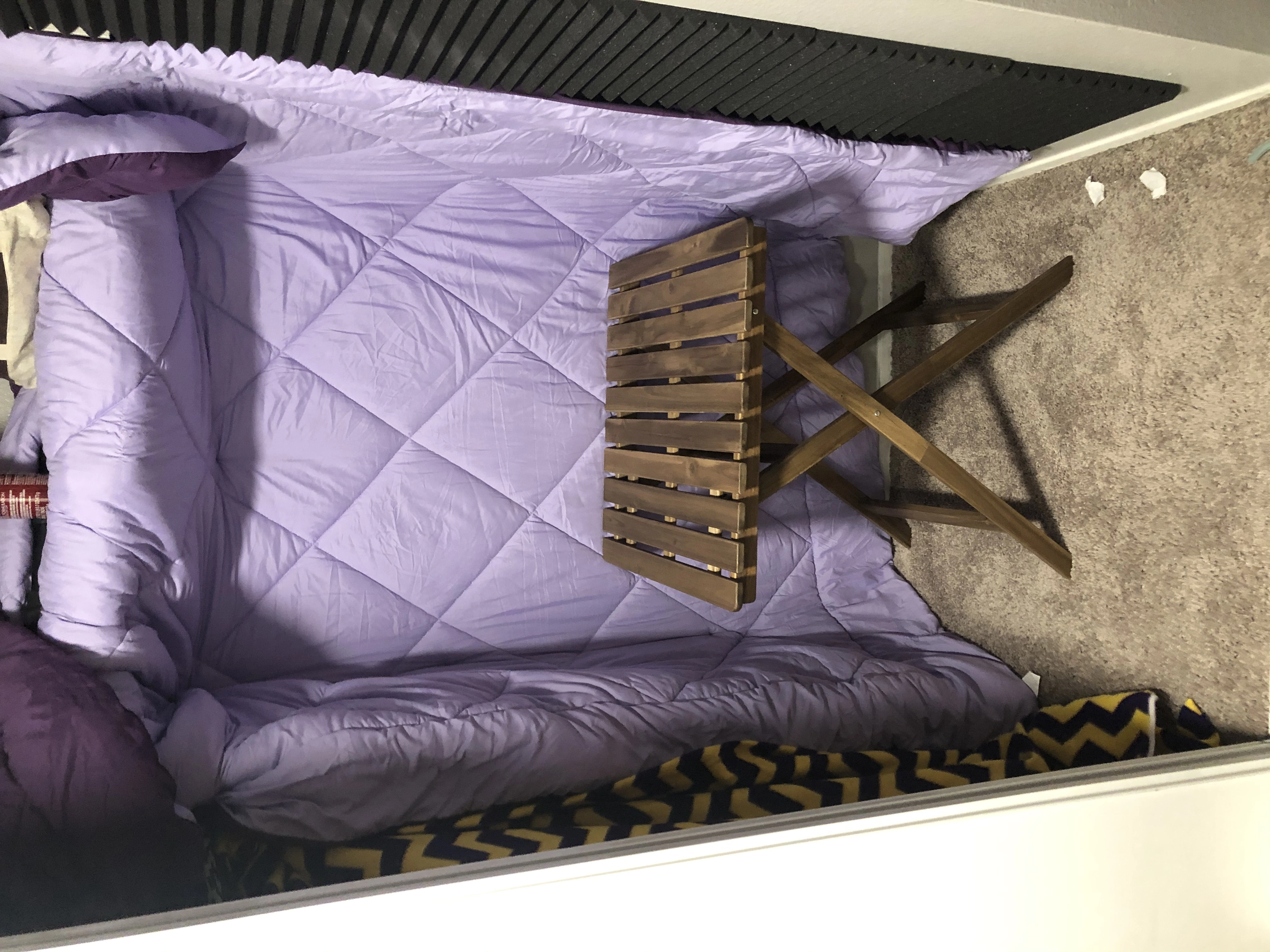

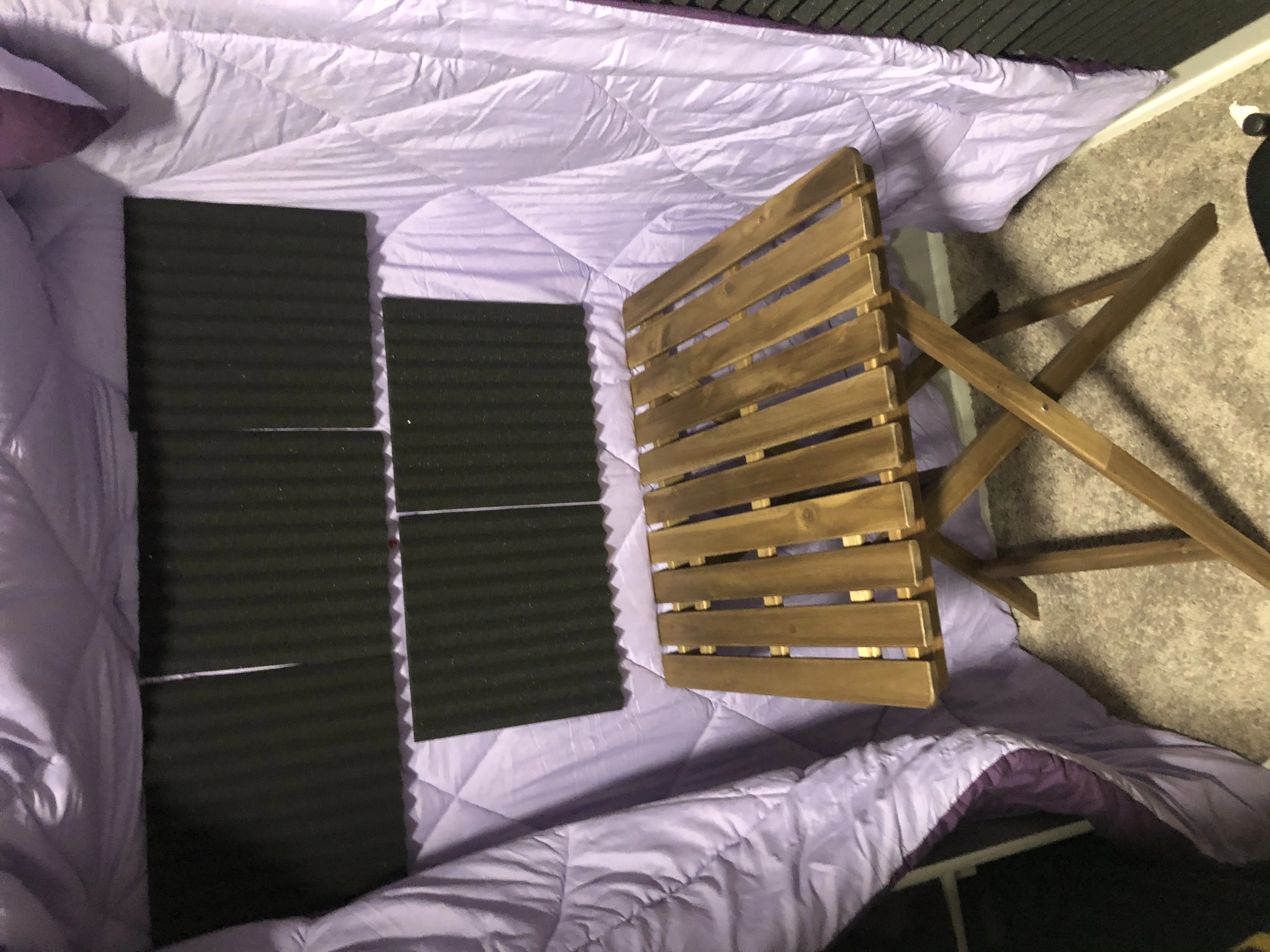

Yes but then I put blankets and sound panels in it.
What kind of sound panels do you have? I'd suggest augmenting or possibly replacing if you've just got foam panels. You could take half your mic budget and buy panels for in front of your mic and maybe a cloud overhead, and even a pair of gobos behind. Then look for a used mic with what you have left.
But, maybe start with re-doing your test voiceovers in the rearranged space and see how that sounds. If there's room echo, that needs to be dealt with before the mic upgrade IMO.
Do you guys hate it? :D (The table has a cover that goes on it, im going to buy a new one prob. My other space could fit something no wider than 24 in and this is all I could find)
