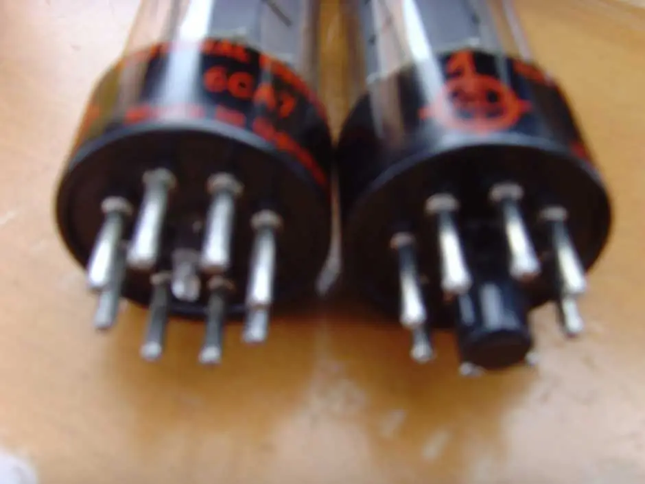

when I pulled the tubes out very gently it seems as though one of them is damaged. part of it stayed behind inside the amp!!!! what do I do??

well, I pulled the piece of plastic out; plugged in the amp, and blew another fuse.

Take the advice in posts 19, 21, and 22 - take it to a repair shop-pronto!
the part that came loose is just to keep you from misaligning the pins... as to the fuse... you have a major short there somewhere... either the rectifier is bad..(is it a tube as well?) or the filter caps are roached.... sounds like it's time to see a doctor.... does it smell real bad (probably not or you woulda said something) if so it could also be a tranny...
