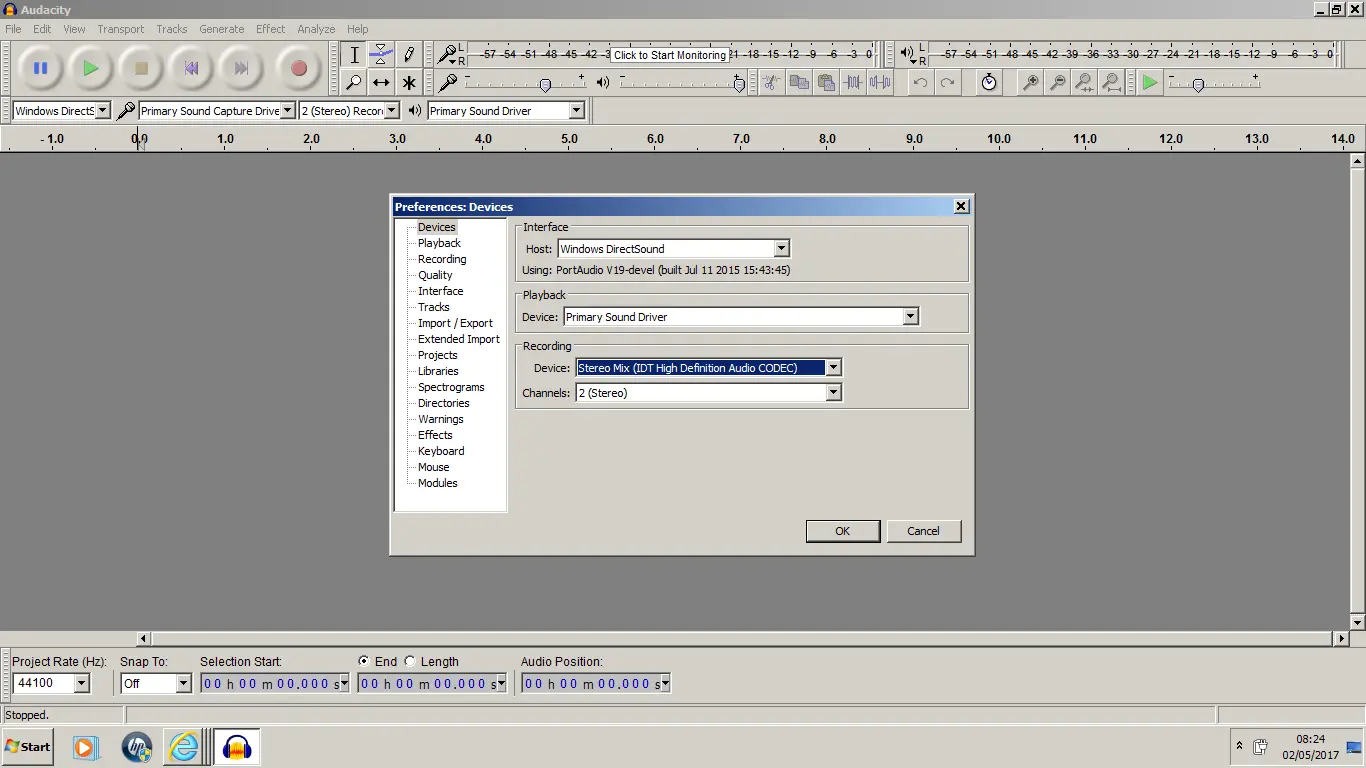

Attached is the setting in Audacity (grabbed a bit of Radio 3 if you wanted to hear it) . Go 'Edit> Preferences>Devices...
How you get the audio in the PC to use Stereo Mix depends on your operating system. I am all Win 7.
Since this setup just records any audio going through the PC it should (must?) work for Facebook but I don't use that.

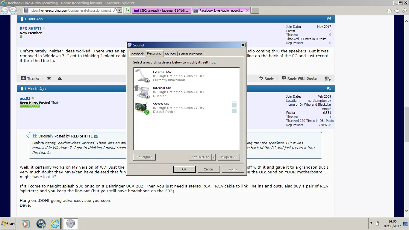

Well, it certainly works on MY version of W7! Just the basic Home Premium. I no longer have a W10 PC, got pissed off with it and gave it to a grandson but I very much doubt they have/can have deleted that function? I think it is part of the 'Realtek' sound drivers. I suppose the OBSound on YOUR motherboard might have lost it?
If all come to naught splash $30 or so on a Behringer UCA 202. Then you just need a stereo RCA - RCA cable to link line ins and outs, also buy a pair of RCA 'splitters; and you keep the line out (but you still have headphone on the 202) .
Hang on..DOH! going advanced, see you soon.
Can you get to the attached from Recording Devices?

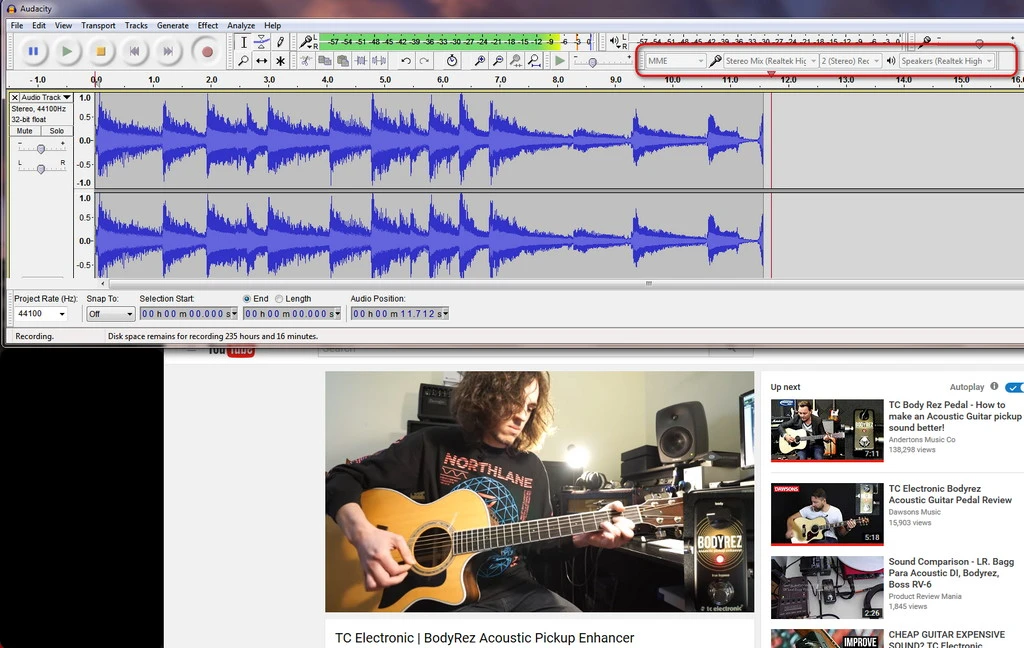

This was a quick audio grab from Youtube that should be no different than Facebook as long as the audio goes through your computers soundcard/sound system. It should be doable.
