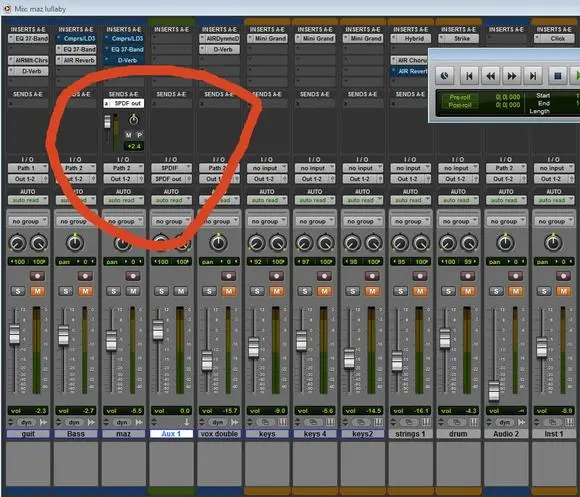

Dry sample vocal track sent to SPDIF (stereo)
Aux chanel set input from SPDIF and viola! nothing
The signal is registering at the MX 200 and if I connect analogue cables the effected signal is working fine but no return from the digital...

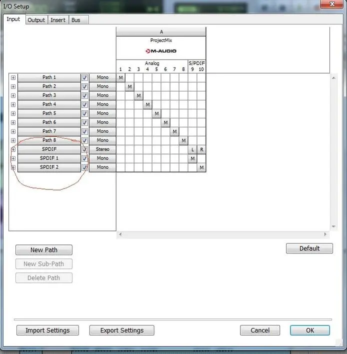

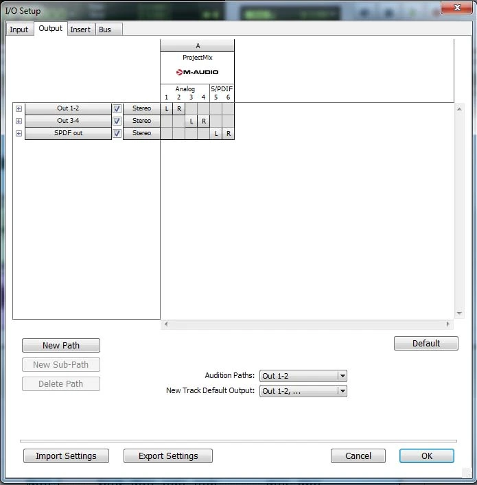

Ive checked the MAUDIO control panel and all is well
My routing seems fine but just cant get the signal back...
