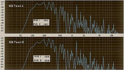

Attached is an FFT analysis of each file at the same point in the file (on a heavy downstroke).
Note that EQ1 has a bit wider of a range and a just bit more RMS volume. EQ2 is slightly narrower in range and a just bit lower in RMS volume. I think my ears personally interpreted those differences as the extended LF range and slight volume boost in #1 being "warmer", and the narrower range and lower volume tending to accentuate the high mids a bit more in #2.
Interesting how that "listening/interpretation" is not so clear cut across the reader's listening spectrum.

Thanks for the replies guys. #2 is the one WITHOUT EQ and #1 is the one with EQ. I was trying to go for a more 'pop' acoustic sound, not sure if that's what I got. I was also trying to use it sparingly.

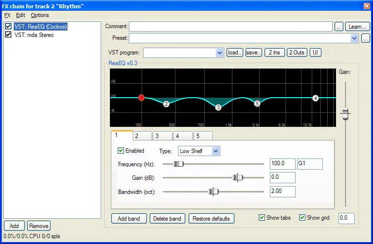

If anyone is interested I attached the EQ I used.

So you did subtractive eq with no makeup gain, but the track is louder?
Also, what is that stereo plug? is it on both tracks?

mda Stereo takes a mono track and creates a stereo image using the Haas effect. I used it on both of them.
I rendered the track twice, once with EQ on it, the other with it turned off. Then I opened the WAV files in an editor and normalized them.

I think the cuts made in the original post weren't all that noticeable. The "pivotal" freq ranges in the unprocessed file that I'm hearing are the area below 200 Hz, and the area around 4 kHz. But to the credit of the plug used it didn't make it sound phasey or processed either, as some EQs do. If you make a low shelf cut with a gentle curve from 0 dB @ 350 Hz to -4 dB @ 100 Hz, and fairly narrow bell cut @ 4kHz it brings things more into balance for a gtr-as-sole-accompaniment type sound IMO. I tried those settings out with Reaper's ReaFir and the PLPar EQ3 and liked them. More low end rolloff and less upper mids cut would suit a strummed part in a busier mix, to my ear. Just my own opinion. YMMV.
Yea I've noticed the phasey sound sometimes with EQ before with severe boosts/cuts, especially in the wrong frequencies. EQing an acoustic instrument takes some practice.
I'm gonna try your suggestion on the EQ and see what it sounds like, thanks.
