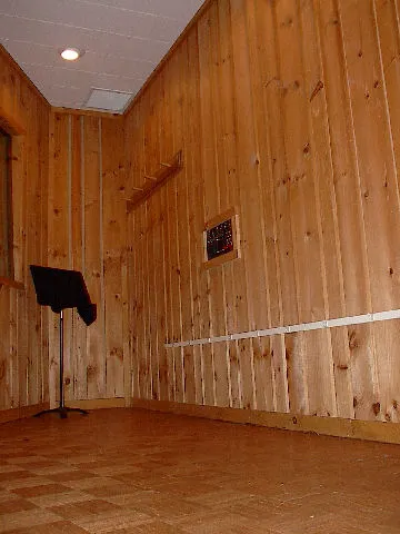

For what it's worth,
In pro studios I do not run the power wiring below the slab, this space I devote to low voltage wiring for the studio.
I run the line voltage high in the walls to avoid creating issues with 60 cycle noise on my low voltage wiring running to the gear.
I like to use strip outlets that are totally isolated from any low voltage connections (refer to the picture of the iso both - you can see the plug connections and the connections for mics, instruments and headphones).
If one is going to use standard outlets this is not a problem.
Tests have proven that in double wall construction there is no significant loss of isolation when outlets are not run back to back.
DO NOT CAULK THE POINT WHERE WIRES ENTER THE OUTLET BOX. This is not in acceptance with the NEC.
If you wish to use outlet boxes and want peace of mind about your isolation - use putty-pads - they give an additional 40dB (weighted) isolation and are code compliant.
If you do run low and high voltage wiring beneath the slab - keep them as far apart as possible - and don't ever run them side by side (parallel) to one another - if they have to cross - make sure to do it at 90 degree angles - this will minimize possible interference.
