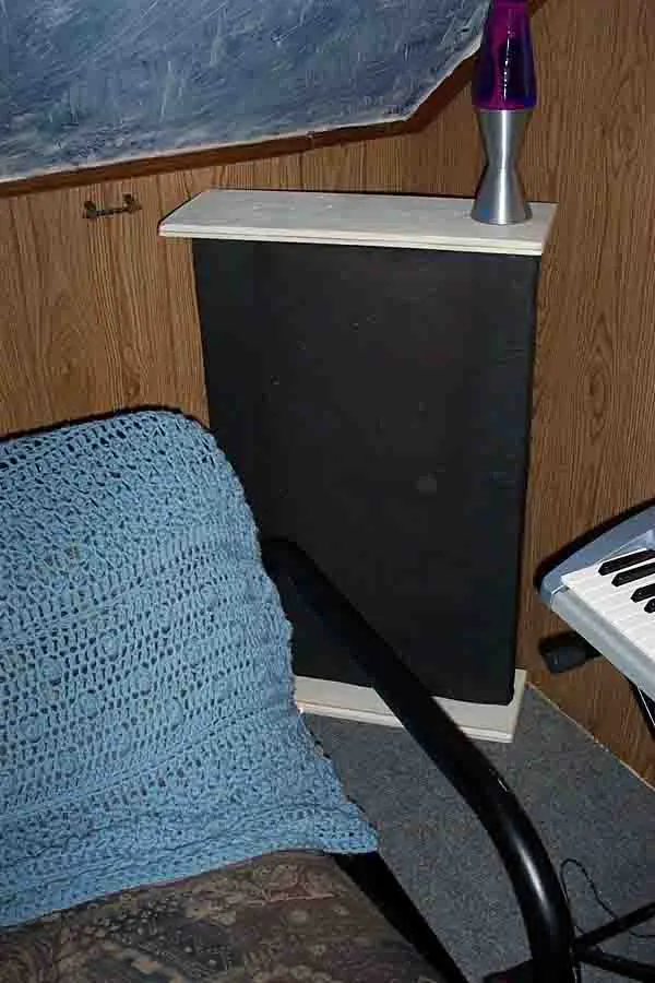

gvarko New member Mar 8, 2004 #1 Slapped together a few of these this weekend. Contains about 10" of R-19 fiberglass in a wood casing, wrapped in batting and black material. They stand 3' tall and are about 2' wide. They seem to tighten up the bottom end a bit... Attachments sound1.webp 56.7 KB · Views: 234
