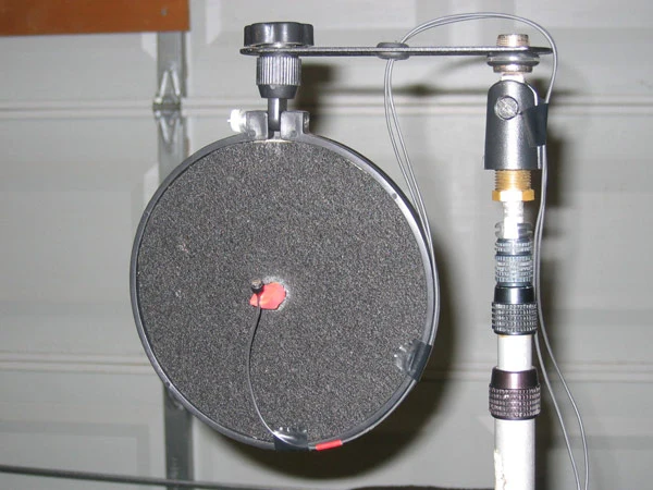

Thanks for the clips! Those do sound pretty good. Do you have a picture of your JDisk and 4060 set up? BTW the diaphrams are supposed to be 8 inches apart with the jdisk inbetween right? I think I read that some where.

I do have a picture of the jdisc...I DO have one with the 4060s attached, As far as placement..experiment..buck the system, use what works for you, I have gotten great results using mine, the best recordings i have ever made.I say that with 100% honesty. In my opinion, there is no other way to record acoustic music.

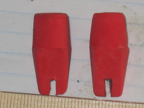

bump for edit, because i do have pics of the dpas attached. they are tiny but have HUGE sound
