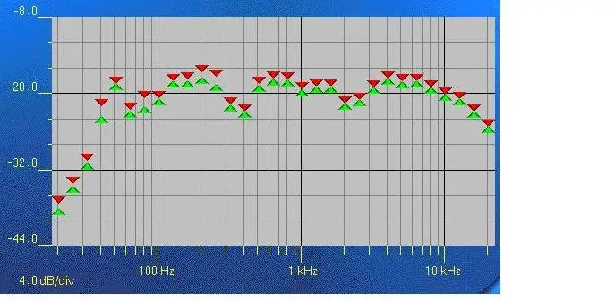

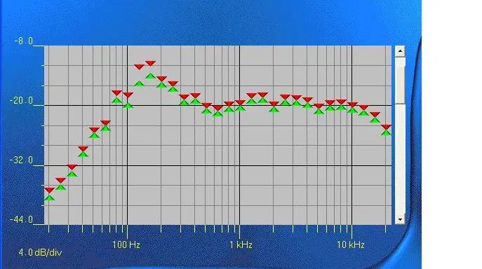

one shows ysm1p standard.
one sh jpg. shows the 150hz pulled down with 150hx EQ cut Q16 will do it.
for $380 pair Active, pretty impressed still.

Seems like your room is having a big effect on the bass response. In my room the stock Yorkies actually had a wide dip around 200Hz (as they seem to in most locations), but are also quite flat all the way down to 40Hz. My modded ones are flat to 35Hz and useable to 25.
Keep in mind they are generally "supposed" to be used with the +2 bass switch as a baffle step compensation. This will flatten out <100Hz a bit. Also give the bass drivers some time to break in. Might just be your room though.
What surprises me is the RTA not showing the brightness of the tweeter. I think that maybe a higher density of measurements would bring this out. Did you have the highs on -2?
Looks like your EQ cut is messing with harmonics as well.

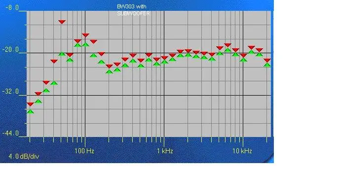

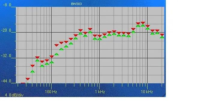

Here's the BW303 with and without the sub. done today. No EQ.
I paid for the $10 and got the Allen Heath RTA full version last night.
The trial version was my first go at this stuff, pretty cool. I noticed like MSHilarious's graphs were more detailed, but i didn't want to spend $50-70.
I only checked the sitting position, as I said this is my "room tuner", kinda like those $14 guitar tuners. I love it actually...real time response, much easier than the hand held.
even Allen Heath says the RTA is only part of the equation, your ears make the final call.

One thing to remember about RTA's, is that the quality of the RTA and the mic used can seriouly affect the readings. If you use a software based RTA program, than you also introduce one more variable with your converters. In any case they can still be useful, but without a truly accurate RTA system, a lot of the details may not be fixable. For example, maybe the RTA mic you are using is causing a bump or dip somewhere do to it's own inaccuracy. Also, its a good idea to use a shockmount when running low frequencies so that you don't get exaggerated readings from your mic stand conducting.
When I last RTA'ed my room I used a Klark Teknik analyzer with the supplied KT mic. It's certainly not a cheap setup ($2k or so), but worth it. i would actually recommend that you do what you can with whatever RTA you have, but if you are really serious about it, rent a top notch setup to do the final stuff.

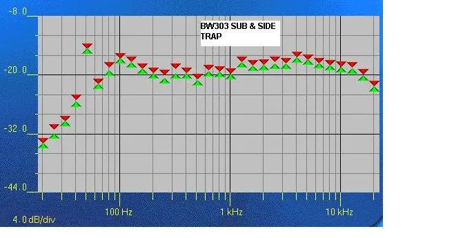

another post with portable side trap adjusted, sub added and fine angle tweeks, NO Eq used.
off for the ysm1ps fine tune and then i'm done with the rta for awhile.
mixing time!
left the pink noise on for break-in time.
funny even when both speakers charts look the same , you can still hear a difference? is that what term depth is?
and i can hear more reverbs on the YSM's...

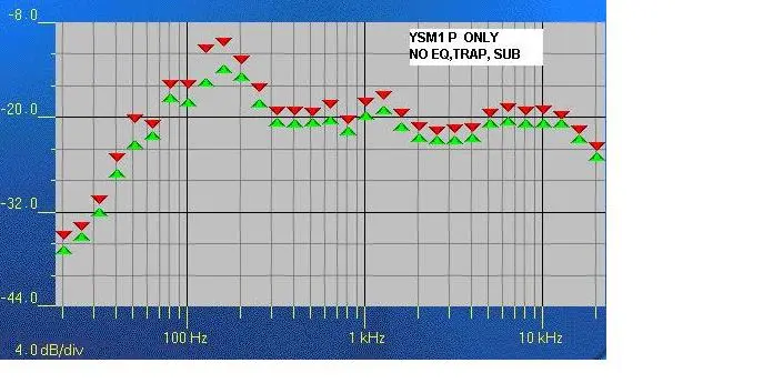

last rta...YSM1p only, no trap,eq, no sub.
pretty damn good imo.
the 150hz bump makes me curious, if i only do the left or right side by itself the bump is smaller....left+right the 150hz increases ~1-2db...
??so would you call this a "room node" an additive type? any suggestions?
i tried this 2nd time i couldn't get rid of it. :confused: .

Or maybe the little 150hz bump is also a Yorkville thing, or a combination etc... etc...
You could try measuring outdoors for near-anachoic response figures.
I realize you may have to make a compromise for your room, but I would be really dissapointed if I had to have the bass on -2 for the Yorkies. Like I said, they are designed to be run at +2 as a baffle step compensation for the flattest and lowest extension possible. At that setting I never feel the need for a sub. You are probably losing about 10Hz of useful bandwidth at the extreme low-end. I would look at changing the placement of the speakers in the room to try and eliminate that bump so you can change the bass setting.
i'll try the +2 again. not sure what baffle step compensation is?
....i'll go read up. :confused:
laid the room out per Ethans DIY info. so i don't think moving them is a path to take.
I could use more 703traps to pull some more 150hz out?
