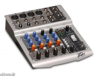

One difference is that you have some control by routing the signal through a mixer. Consider getting a seperate mixer just for the monitor signal - do everything the same except input the soundcard out into 2 channels of the mixer, or a stereo channel. Use the mains for your monitors and you'll still be able to use a headphone. You'd be using an inexpensive mixer as a monitor patchbay. Something like this would work:
http://www.zzounds.com/a--2676837/item--PEVPV6
