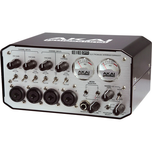

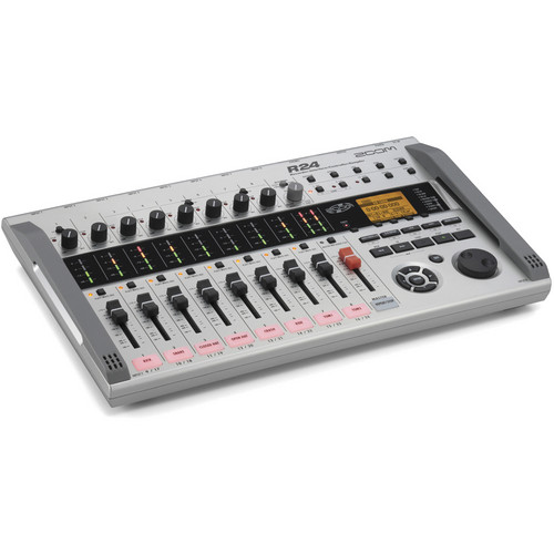

You need to be brutally honest with yourself as to your budget and your needs. If you see a point in the near future where you are going to need four mic pres and you have the cash you would be doing yourself a disservice to purchase a piece of gear that only has two. If you can afford to drop $500 then you should be looking at gear that costs $500 or less and that will meet the needs that you have determined. Every thing that follows is from B&H, has at least 4 pres, interfaces with your PC via USB, and costs $500 or less. Note that ALL of this gear will do what you want it to do, just that SOME of it will do a lot MORE.
Click on the picture.
