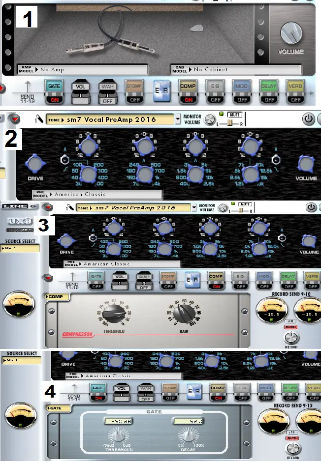

I'll add this- I took a SM7 and a cable plugged it into Mic 1- Selected Mic 1 as the Source.
Volume pre was max and volume digital max to barely hear it. Add Gearbox(old PodFarm)... maybe a picture is better. The small audio clip walks through it too... this is going in and obviously would be tweaked during mixing or verbs added etc.
