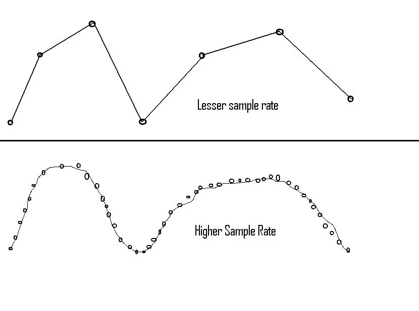

I attached a simple picture of what I just drew to show some of you an easier representation. There's a reason why Nyquist did what he did. Even at 96khz, that doesn't exactly mean that it's capturing sound from 20khz to 96khz, it just means it's capturing more pictures between whatever sound it could be, maybe between 50hz & 80khz, or 200hz to 1k. They added the extra 2-3 for alias problems that arised, but yeah, the better a/d converters, the better it is, but everyone knows that.
Haha, that is really misleading. Generate a 20kHz sine wave at 44.1/16, play it out of your soundcard's DA, and into an O-scope. I can guarantee you that you will see a very normal sine wave (perhaps a slight attenuation from the original amplitude due to the filters being so near with 44.1k), and not the jaggedy piece of crap that you show.
It just illustrates that a lower sample rate means less samples are captured per second to the hard drive. But you are right, this question of sample rate can't be answered by theory alone ... it has to be answered practically ... so get out the system, and record some stuff at 44.1khz, 48khz, 88.2khz and 192khz ... see which sounds the best and by how much does it sound the best. If you end up being faced with "higher sample rate "X" sounds better", then ask yourself if it's worth moving up and consider any baggage the move will bring (higher CPU, higher HD space being eaten) ... it might very well be worth it for some.
