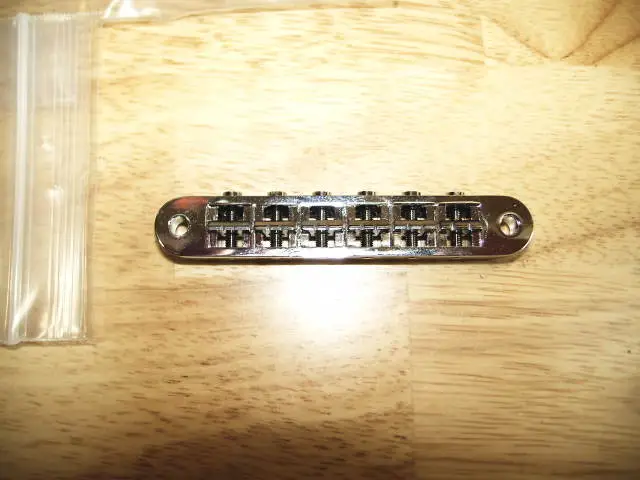

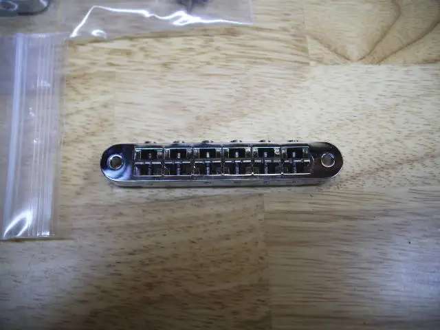

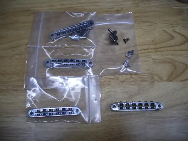

Here are some photos, After numerous contacts with Gibson, they kept sending me the wrong bridges, they finally did send the correct bridge though, but it is already PLEKed, how can they possible prePLEK a bridge without having the guitar in front of them? They are now supposed to be sending me a virgin bridge so I can take out the saddles and redo them as needed, They tried sending just the saddles but kept sending the wrong ones.
VP

My nut slots and saddle slots are inconsistent. The slots on the same saddle for the paired strings are way off, for example the octave D string bottoms out and buzzes while the lower D string is quite high. It is just a bad job all around. When I set nuts and saddle slots I use feeler gauges and other gauges to accurately set the slots to conform with the given radius of a fretboard. All of my other Gibson were done very well in this regard, just not the PLEKed SG 12 string.
VP
Honestly, that sounds like user error on Gibson's part. The PLEK process is computer controlled to remove issues like inconsistent nut heights, so if the process is being done correctly (and, again, I don't believe it is - I've read that Gibson doesn't PLEK under string tension) you shouldn't be seeing wildly different heights.
I'm also wondering if the PLEK doesn't currently have 12-string support, and if the octave slots on the nut are being cut by hand, perhaps...?
I was told it was PLEKed, I think in the specs they mention it, but in any event bridges should never be slotted before they are installed on a specific guitar.
VP
Quick edit from the expert. I quoted "They only go one way." I guess that was too obviously incorrect.
They only go one way when they are already slotted, especially in a 12 string (different size slots). Even on a 6 string the slot is not always dead center, so reversing it would throw off string spacing.
VP
Tune-o-matics go either way and can be inadvertently reversed quite easily. Happens all the time. Can't tell anything from your pic. Is it oriented up or down? Looks upside-down to me but I can't discern slot depth at that resolution.
I am quite aware of how they work, It came from Gibson oriented in the "Correct" way that it was slotted, okay? However the slots are at inconsistent depths, yielding many strings that buzz and others that are high. Do you understand now?
VP
