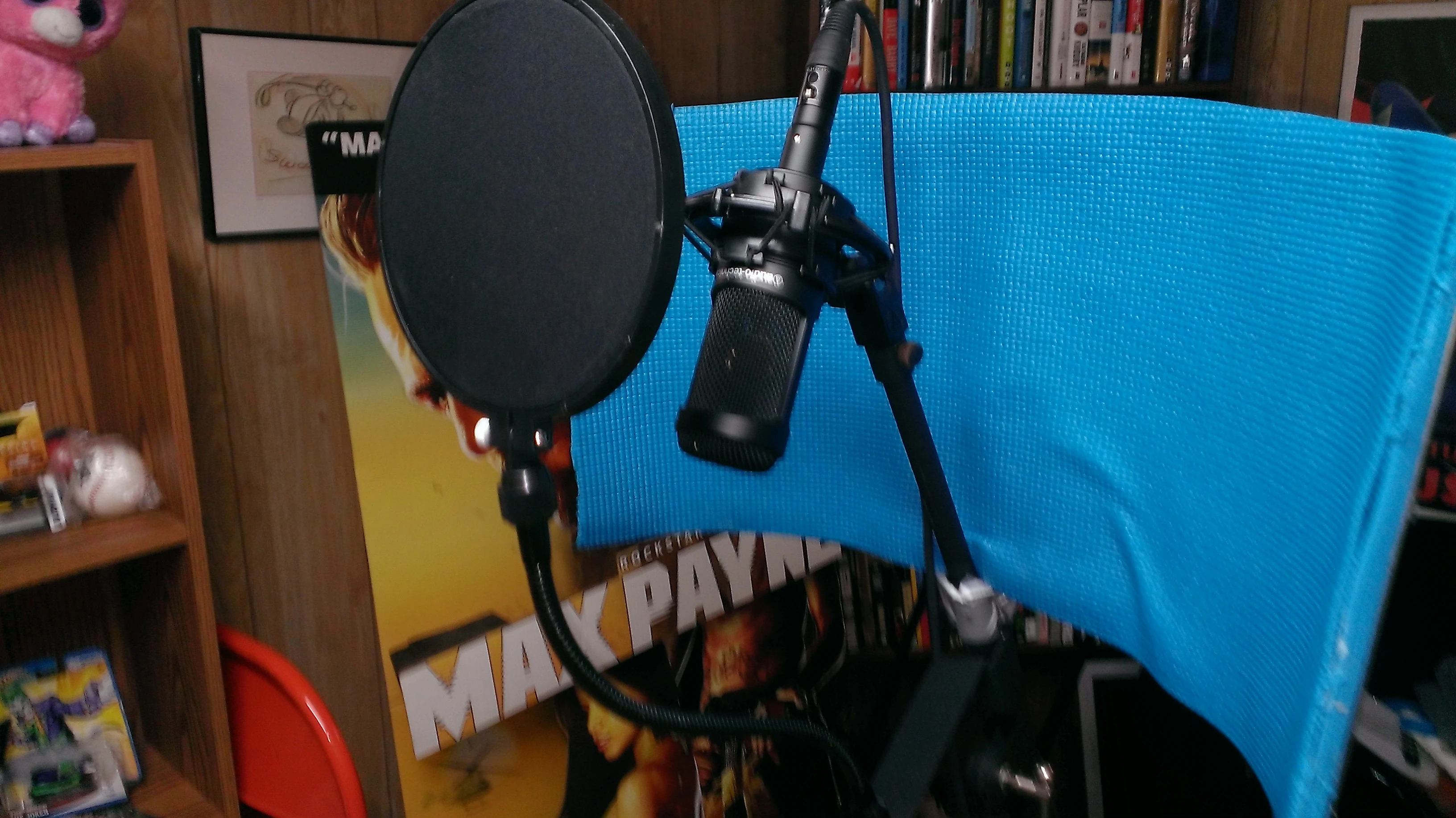

Here's the first attempt: bycE0Yf.webp I didn't get a picture from the back, but this was the result of duct tape, a clothes hanger, and a small piece of metal I found laying around. I t was cumbersome, it never stayed still, and it was just generally awful.

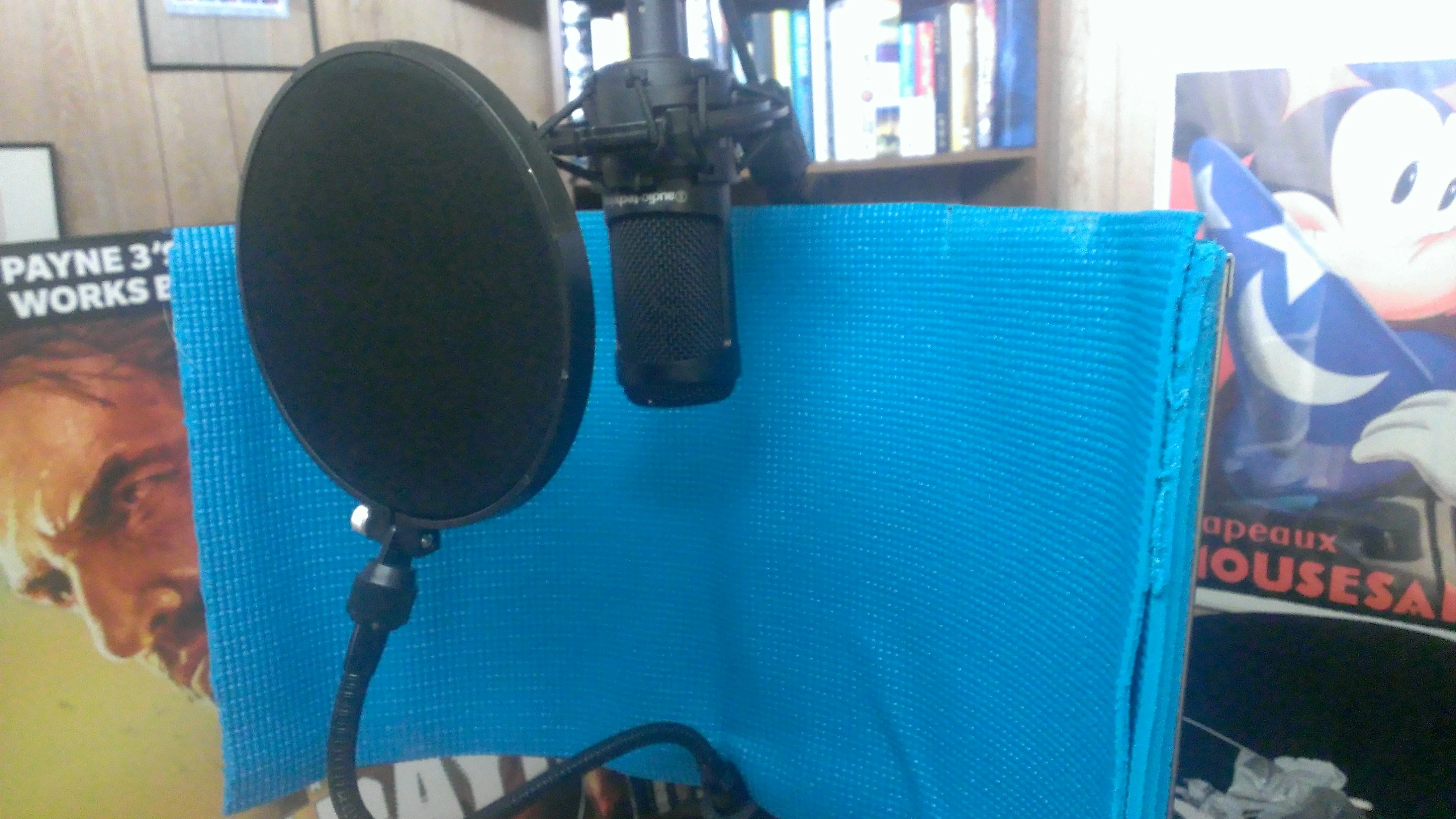

This is the second attempt. All I used this time was a twist tie to secure it at the top of the mic stand. It sits pretty sturdily on the pop filter mount.EieRxX9.webp

I would not mount the mic, the pop filter and the shield all on one stand.
Any time you touch the pop filter, it will transmit the vibrations to the mic.
I usually put the pop filter and shield (when I use on) on one stand, and the mic is on its own stand.
Also....I would pull the shield back a bit more (or move the mic forward. IOW....leave a little more space between the mic and the shield.
OK, I'm sure this is a dumb question, but what's the blue stuff? I guess you're gonna have to describe the construction for me in more detail.

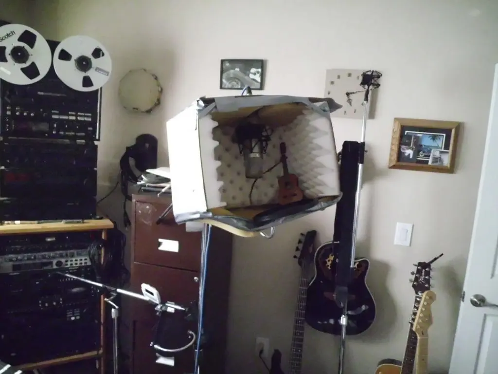

Mine is a bone-a fied vocal booth cuz..It's big enough to even put my guitar in see!:laughings:
