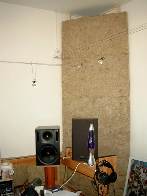

Next I got me some pieces of wood, approx 5x2cm (2x3/4") from floor to ceiling, and attached the panels to it with these white plastic fasteners:

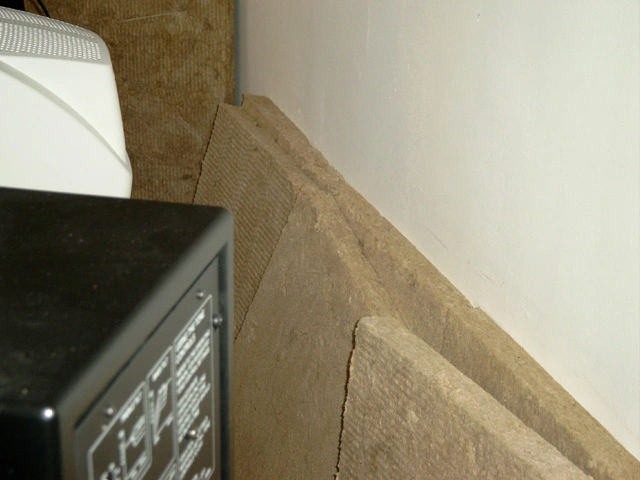

These are the panels I have left, will put them on the wall where I have first reflections of the monitors.
already now I have way improved bass sound. Mind you, this was a near-square room (4x4.10x3.13 m) and I was having serious sub 200Hz problems.
not scientific at all, but my ears tell me it works :D :cool:

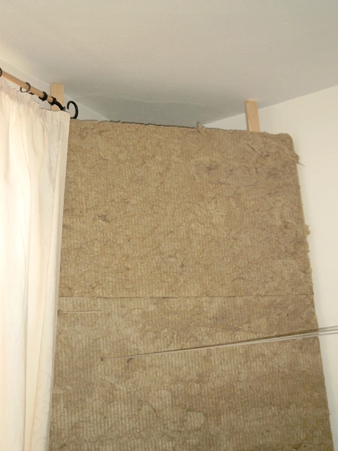

I'm gonna ad some rockwool at the top too and will put some cloth over it because now it's itchy time. Yikes this stuff is MEAN!
Oh yeah, and this cost me €16.37 per 6 panels + about €3 per piece of wood + one package of fasteners... which is about €60...
Maximum space between rockwool and corner is about 54cm which should make the trap efficient to around 150Hz (330m/sec divided by 4x0.54)
Room sound very different off course, I didn't realise I still had that much reverb going on before I put up the treatment, and songs which I know have bass problems but couldn't hear before have now very prominent bass in them.
