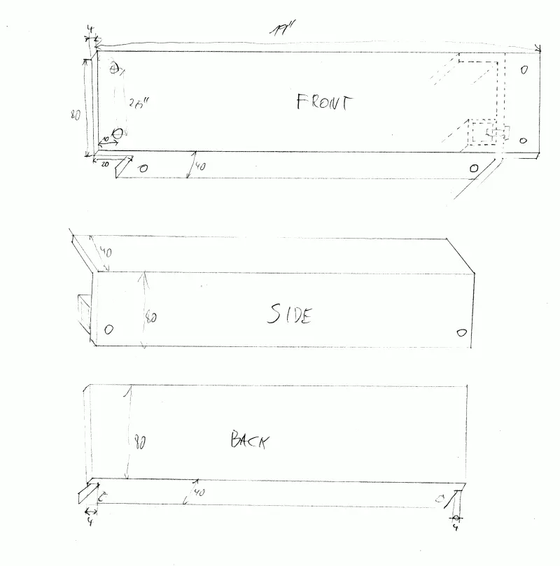

Ok so I figured how to do it with my limited variety of profiles, I will try to draw it :)
It uses four L and two square profiles.
The only problem for me is that there are no profiles here with height suitable for 2U, so it will be about a 1/3" smaller.
Dimensions are 19" wide, 250mm long and 80mm high (2U is 88).
Anyone interested in the sketches?

I have quite good experience in machining, I built a similar chassis for my DIY 2x250W amp, it is only a bit less wide than 19" and doesn´t have the sides for screws. And the chassis cost me like 20$.
plan
So here is how it will look like, if there is anyone interested. This version is made of 4mm thick L profiles, but that seems a bit overkill for preamps and such, so I will use 2mm if i can find them somewhere.
BTW most dimensions are in milimeters, only the rack-defined are in inches.
