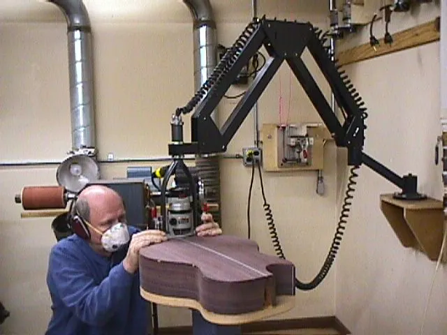

We've seen them, but as I don't do much binding (I'm building electrics, and seldom bind them), I don't worry too much about it anymore. I'm guessing the reason dad hasn't tried one of those is that Jim Olson showed us his version. In typical Jim fashion (this is a guy who showed Bob Taylor a book of the things Jim had done with his CNC machine, and made Bob go, "You've done more with that thing than my team of 20 guys!"), his is so absurdly over the top perfect that it makes you feel a little inadequate.
attachment.php

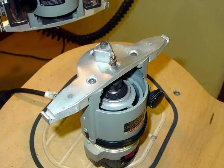

Above and beyond the arm that holds it all, he also made aluminum base plates for his routers that allow him to use spiral bits, so the base acts kind of like a bearing guide on the router (instead of a bearing bit), but unlike the normal router attachments, it gives about 240 degrees of rotation.

Thats crazy, My dentist hasn't got an angle poise that good.:D
The one I built was based on Don's with a few mods that Bill Moll came up with. He used to do his by hand with just a doughnut base on the router, braver than me. I'd sooner do them by hand.:eek:
I can't imagine I'd need anything bigger or better, but each to his own. Besides you have no idea the trouble I have getting spiral cut router bits here, you just can't get them. I have to special order or get them made.
I've never been to Jim Olsen's workshop, I've chatted briefly a few times. I'd love to visit but I'm rarely over there these days as I don't do the shows anymore, I will get back to Healdsburg one day soon though. There is nothing better than seeing solutions other people come up with especially guys like that, FF is another wonder for thinking out of the box solutions.
Just the arm cost him something like $2,500. But when your guitars start at $12,500.00, I guess you can afford things like that.
Of course, you have to remember something about Jim. This is a guy who buys a new router (and bit, of course) every time he sets up for a job. He sets up the router once (taking enough time to make sure it is 100% perfect), and then leaves it that way forever, so he never has to go through the set up again. He has taken the idea of the one-man production line to the furthest extreme I can even begin to imagine. His shop is unreal.

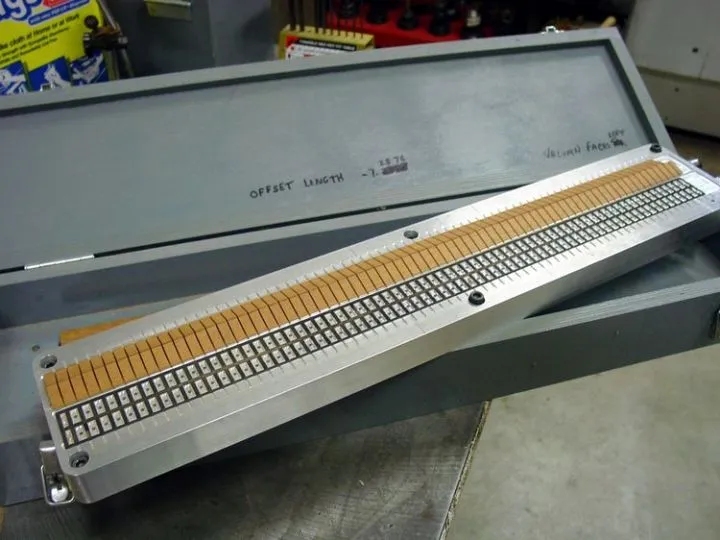

Then there is his vacuum hold down jig for cutting linings.
attachment.php
He was having problems with air leaking through the curfs, so he cut individual slots for each block in the lining. It's so over the top, you just sit there with your mouth hanging open going - OH MY GOD (but do it quietly, Jim is very religious).
Here's a picture of one of the bases for his binding cutter.
attachment.php
