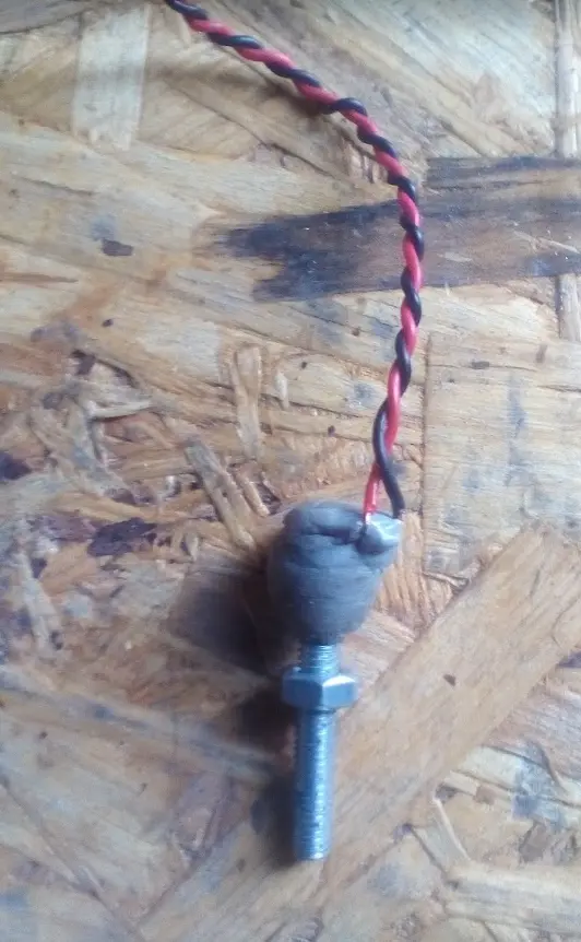

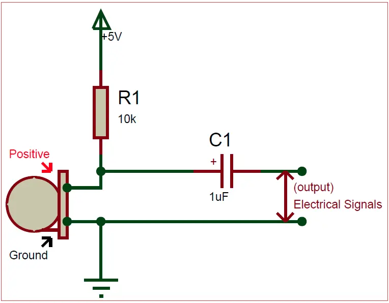

I think the 'direct source pickup' is an electret microphone configured to work like a contact microphone. So I tried making an electret contact microphone by attaching an electret to a flathead bolt with epoxy putty (see pic).

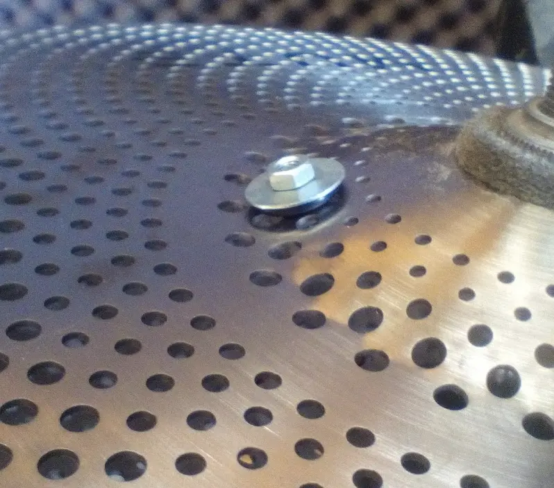

I hooked this up with a 50kOhm logarithmic potentiometer to a VM114 7W audio amplifier (velleman). For now, I'm powering the mic and the amp with a 9V battery (I could get a low noise audio power supply in the future). The contact mic is bolted trough a hole I made in an old sabian solar 16" ride (not a great sounding cymbal to begin with!).

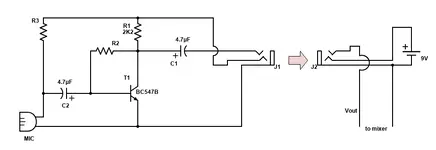

I used the schematic in the attachment. But instead of a 10k resistor for the electret, I used a 1M resistor and I switched the capacitor for a 1000µF capacitor (it seemed to give les distortion). I also attached an small sound sample, doesn't sound that bad, but it could be better (the sound is only contact sound, there is no ambient sound picked up, which is great).

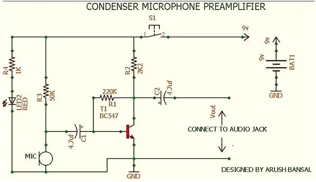

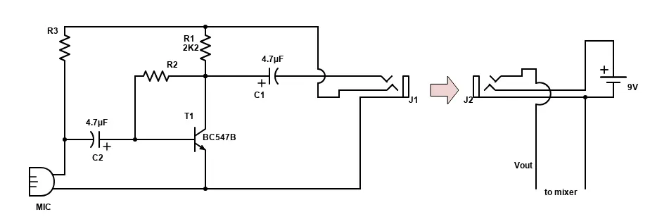

OK, I discovered that the 7W amp is a really bad idea. Ik need a preamp of course. I used the following circuit
This gives way better results, much less distortion when it's played loud.
If I hook this up to an equalizer I might get some decent results. I also ordered a higher quality primo electret capsule (Primo EM172-Z1), can't wait to try that one.

I suggested those pages because those circuits should also work with the electret capsules that you have. However, you ought get reasonable results using the simple circuit in your first post provided you use the component values shown in that circuit diagram (1M ohm and 1000uF are definitely not right) and connect the output to pins 2 and 3 of the mic input on the Quad Capture.

I want to power multiple preamp + electret circuits with the same power source. Would it be possible to send the mono audio signal and the V+ power supply with a stereo jack connection?
I would try the following circuit, with multiple mic + preamp circuits in parallel connected to the same power source, each with it's own output to the mixer (only one mic + preamp circuit is shown).
+9V through the ring connection, ground through the sleeve and the audio signal through the tip.

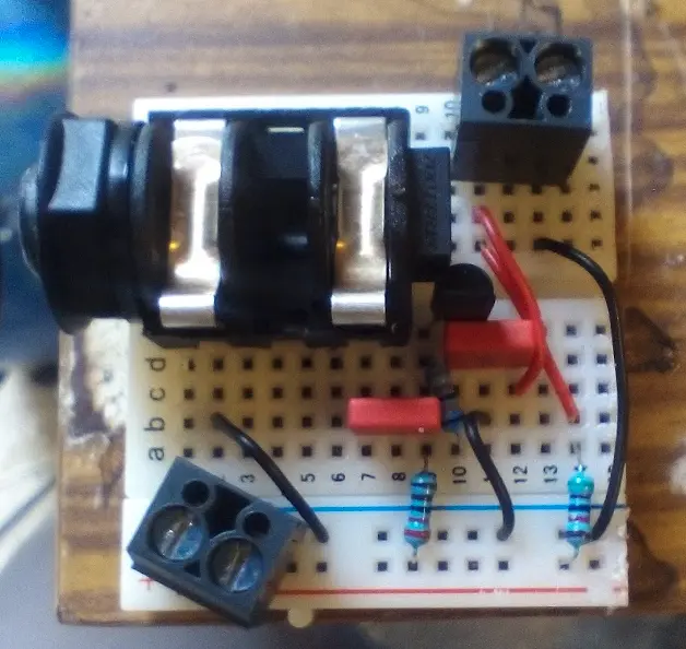

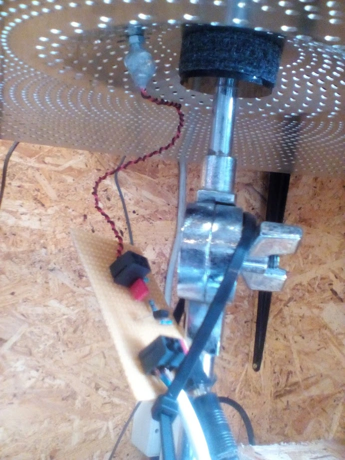

The preamp fits on a small breadboard:

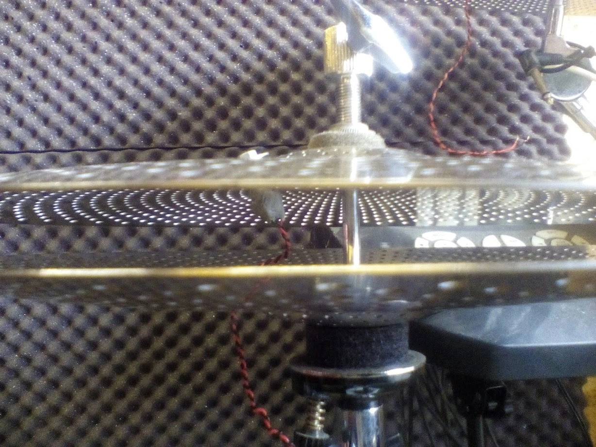

Everything attached to the ride cymbal (tie wraps rule !):
I also had to use a rubber o-ring to dampen the mic, otherwise I would get insane distortion. Maybe the distortion that's left will go away with proper dampening, but now it's time to play the drums :-).
