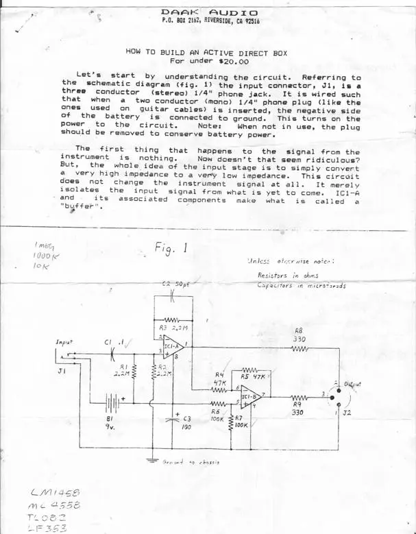

Found this real old schematic
This has to be about 30(?) years old (hey, it's vintage!) but just wanted to post this for S 'n G's. Did a search for DAAK Audio with no results, guess they went under.

That's the basic dual opamp for electrically balanced output. The input jack is TRS, using the ring to switch on the circuit (the plug connects ring to shield when inserted). Of course, that uses a 9V battery rather than phantom power.
There are a few things I don't like about that circuit: as it has 1/2 rail bias on its input, so will it on its output. You don't want DC at the output of your DI, that's very bad form. Probably your preamp has input capacitors, but if you switch on phantom power, you could easily destroy the DI's opamp, depending on how robust it is. So output capacitors are a must in my book, as are input and output clamping diodes.
That circuit also doesn't offer attenuation, which could be a problem for some preamps. And I think the inverting stage might be injecting a bit more noise than necessary, but it might not matter.

thanks for the schmatics, it looks really simple, I'll have my friend have a look at it...
the only thing... doesn't it provide with a TRS out for returning the signal to an amp?
A DI is not for connecting to an amp , a DI is for connecting it to a Mic preamp or mixer for recording... If you want to plug into an amp then just plug into an amp....

Sure, just take another tap off of C2. You probably don't want TRS out to the amp, just TS. That is an application where you might want ground isolation, although your amp might lift signal ground above chassis ground. If not, try a small value resistor and capacitor in series with the ground connection if you need it. If you keep the amp and preamp on the same circuit, that should minimize problems as well.
