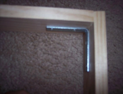

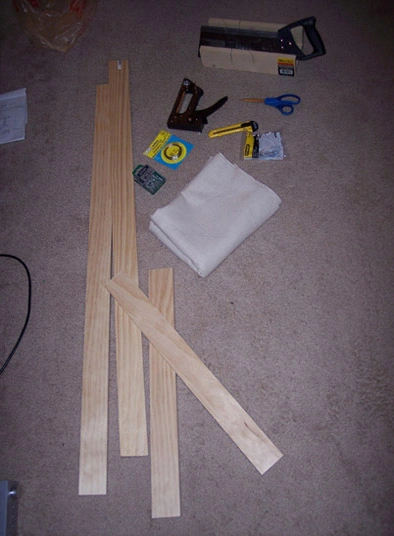

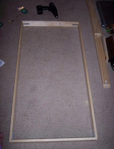

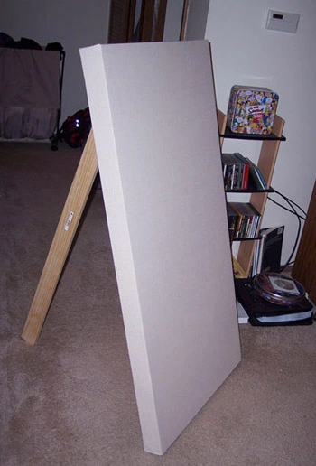

For the newbies here I thought I'd post pics of the sound dampening panels I am building out of rigid fiberglass. They are 2ftX4ftX3in wrapped in two layers of loose-weave cotton fabric. Doubled up the fabric still passes air freely. These are pictures of the frame and fabric only, I'm going to buy the 703 tomorrow. I plan on using 3in thick fiberglass.
