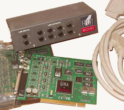

The only thing I have close to the 2696 is the 20-bit ECHO Gina and I wouldn't hesitate to use it for anything
