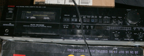

ya, my last eBait cassette was $19.99 - Luxman DBX k-106, and the other three, here, were all in that range. Though there is no USB, etc., you'll get a much better transfer just going into the MIC jack. That includes a 3-head Sony tc k-555, but even my old Aiwa walkman can do pretty good for dubbing.

Well azimuth alignment was much more common when tape capstan wound. hahah I had to align the shelf system, for sure. It didn't look wrecked, or, anything, but there was a pattern on the heads and a couple tape plays would confirm it. Sometimes, alignment is bending all the mounting brackets back into place and the heads turn out to be perfect. A lot of the older Luxman cassettes decks expected users to be dialing in the highs on a regular, or, as needed basis. This newer one, here, doesn't even have MIC preamps - well none do, 'cept the Sony portable dual flywheel tc126

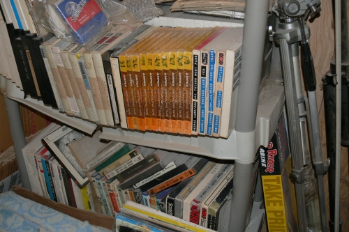

I don't have my old cassettes and records here to digitize, but I have, since, collected open reel back to the late fifties to digitize along with another 150 or so albums + CDs. I'm actually putting much of that on cassette. hahah
Dang, I see the shelf broke in the middle. Two shelves of double depth rows of tapes and the cassette deck I'm putting the wear on instead of the 3-head.
