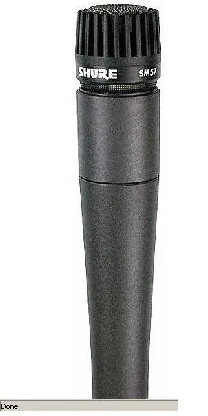

SM57 looks like this....

Right on, mine looks exactly like that, except the writing, the "Shure sm57", is on a sticker, not painted on or whatever.
yes that is supposed to be a sticker. How doe's it sound? I do have 57 knock offs and they sound like crap. The differences between the fake and the real one s aesthetically are pretty subtle. But the fakes weigh alot less and the wiring inside is a much smaller gauge. see how the weight compares with your 58 and open it them up and check the wiring, if the wires in the 57 look alot thinner then you did get a fake, but if they are the same you should be good. The sound is the most important part though and it should not sound like your 58
