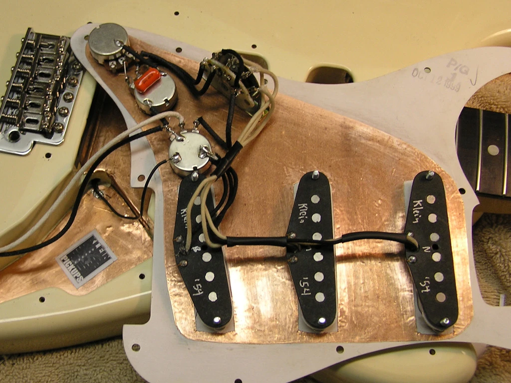

A little more than 15 years ago, I developed an obsession around classic Telecasters, specifically the early pickups. I built a pickup winder with a counter and researched all the documentation I could find and wound hundreds of pickups. When I ran out of guitars to put pickups in, I started building guitars. Really long story as I tend to find deep rabbit holes to explore.
Single coils are always going to be susceptible to noise at least from the front unless they have a grounded cover like a Tele neck pickup but you lose top end. Where a lot of guitars are not equal is how well the body cavities are shielded. Two main methods are copper foil or conductive shielding paint. Where practical, I used both soldering the copper together and to ground. Also made sure the bridge has a good ground. In addition to shielding the cavities, you can also replace single wire with shielded coax. I started using Mogami mini coax in my builds as a standard.
