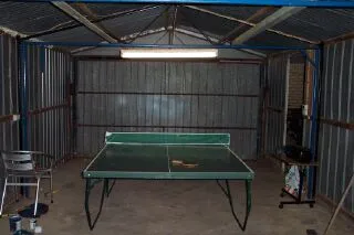

I'm now planning the Constructing a project studio in a shed. been studying the SAE stoof.. a few questions, Just trying to soundproof it first and worry about accoustic treatment later bad idea?

ps. the attatchment is a picture of the naked shed. there's more pictures of the window behind the point where the picture was taken from and the door that ill post later.

nice shed ... that should make a fine studio :)

Now there is a new issue, we want to float the floor but from the pics you can see those beams are already pretty low, about 205cm. so should we gut them out and go for a flat roof or drill down through the foundations and jackhammer those out and put down ones which lay lower down?
any ideas/ sugestions guys?
Thanks, Kym
from the picture it appears that the beams (blue?) are part of the truss that holds the roof up. Why do you feel you need to float a floor? I would have though that an internal wall and ceiling would give enough isolation.
