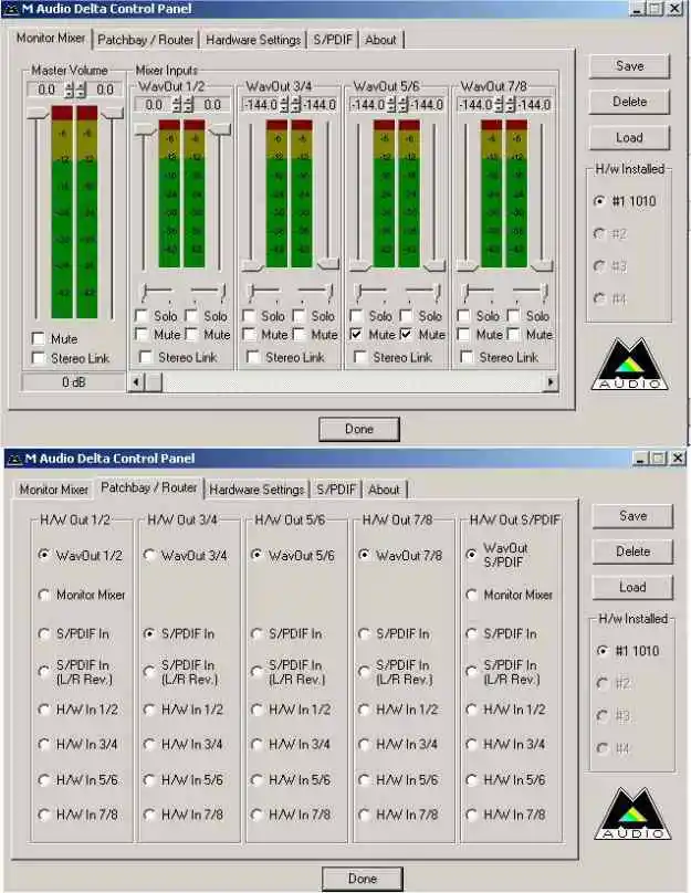

Here's the software side of the equation that comes with the Delta:
You can use multiple delta products in one machine, but yes, it will require a PCI card for each product. The Delta 1010 is a PCI card and breakout/converter box system. The drivers are cool in that they support multiple devices.
In regards to #1, outputs 1/2 can be set to "monitor mixer" as you can see from Doc's pic there. You just set the HW Out 1/2 to Monitor Mixer and you're set.
