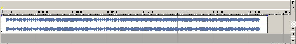

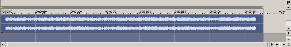

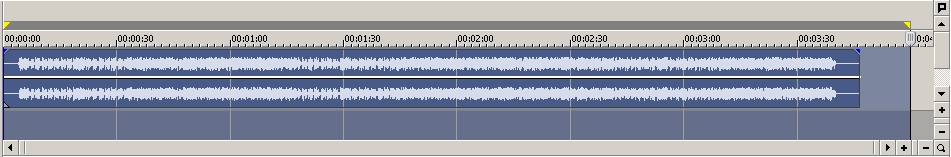

This is what it looks like in Sony Vegas 6. If I double-click a clip I get what you see in the second pic. Then I grab the little yellow flag and drag it to the right.
No timeline selection:

Selection = length of clip:
Selection extended beyond length of clip:
