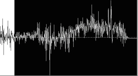

IF your recording/restoration software gives you a view of the file once recorded yopu might be able to see theDC issue. In waverepair - which sets up the wav file as a stereo wave it manifests as the signal beginning & ending below the centre line (see attached image - it's of the last few secoonds of a the left channel of a wave file) - in essence the whole file is centred below true centre.
This can often also be address by running a filter or EQ pass that eliminates signal below 50hz or similar - you'd have to experiment to set it accurately - before you burn it as a CD audio file.
Suffice to say the DC offset tweak is easier & more accurate.
