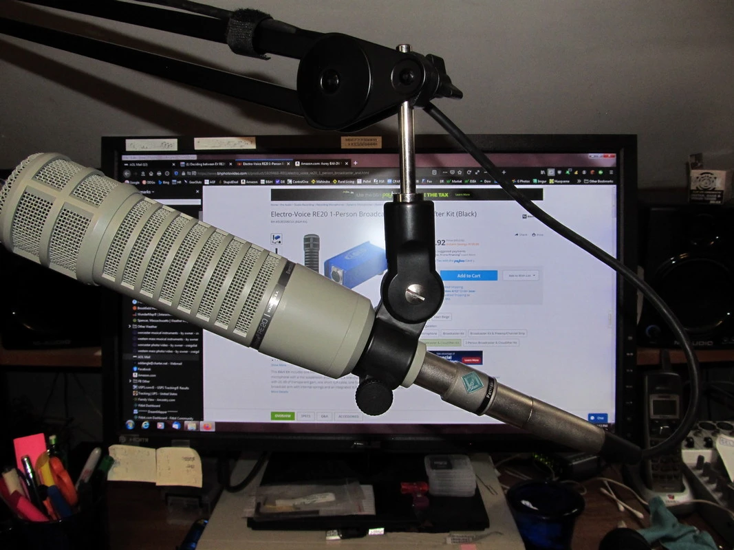

Since this the first day with the new Auray mic boom arm and putting it through its paces, thought I'd mount up the RE20 with a FetHead to see how it supported it :P. Gotta say I'm pleased with this boom arm so far.
Keith, the boom arm offered in the B&H kit is the Auray model with an internal cable. One of the things I read on Amazon was that the Auray internal cable is not all that easy to replace if the need arises. I've Velcro tied the cable on the one I bought and that works well. Before the boom arm I was using the RE20 on a mic stand with an arm and just the standard mic clip it came with. I never felt the need for any shockmount or suspension, although it did pick up foot tapping on the floor if I forgot what I was doing while playing. If just reading VO copy the clip should be OK I think.
Yeah, kinda wondering if the OP might have meant a mic stand with an arm rather than an adjustable boom arm like this. Either would work well depending on budget and need of either leaving the mic stationary or needing to move it.
