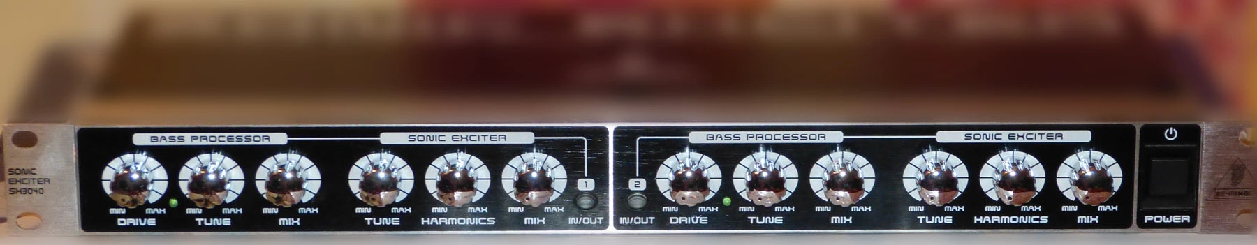

The original knobs are very shiny plastic -- a bit too much 'bling' for my taste - and the positions can be difficult to read.
This picture shows what I mean..

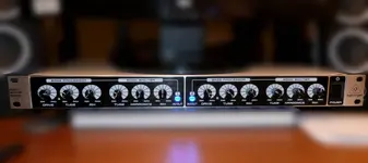

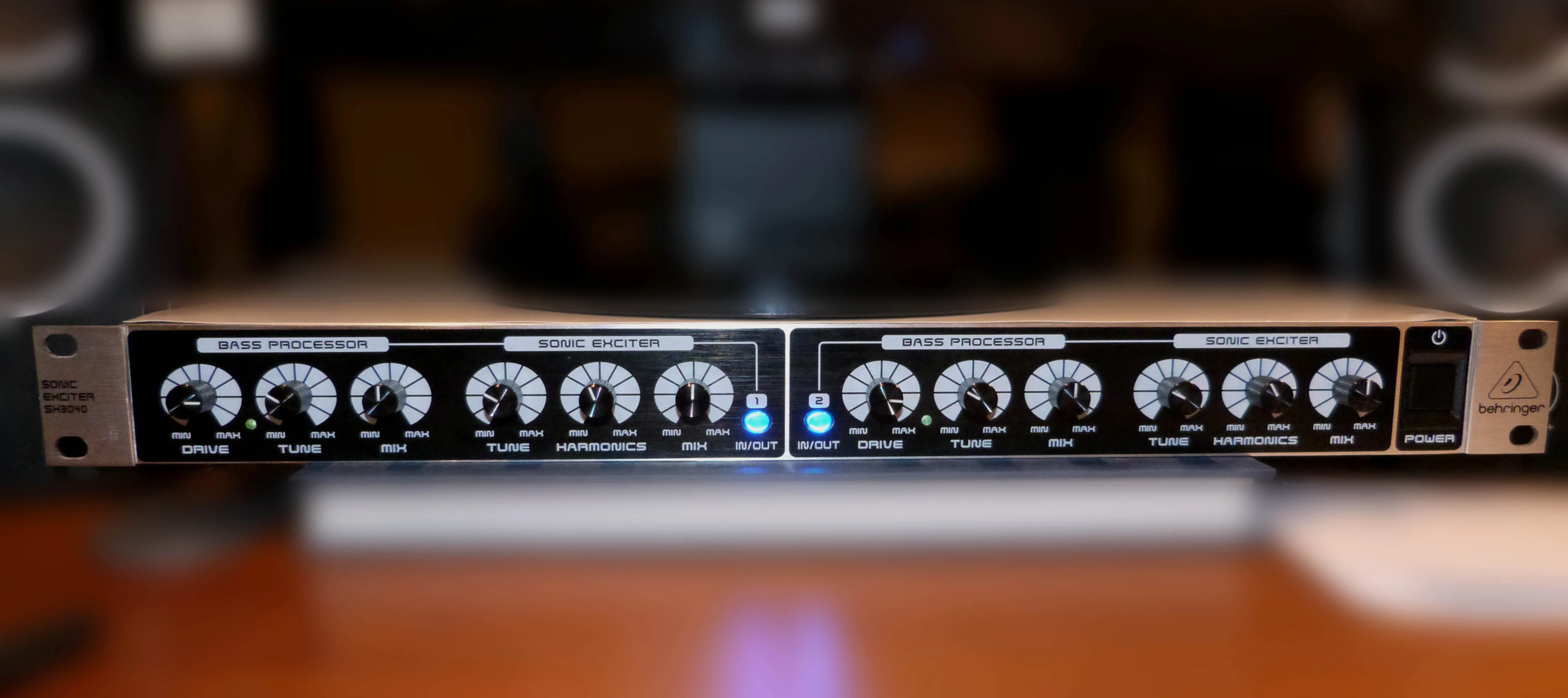

Now these knobs are push fitted to a 6mm 'D' shaft - of which only about 3mm pokes through the front... So the choice of replacement knobs is a bit limited..
I thought these looked OK...
Much easier too read ! Bit too small diameter wise maybe?... but OK apart from that.
