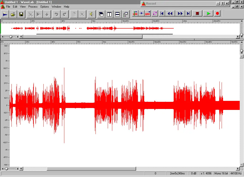

The fuzziness increases in amplitude, but stays perfectly centred around the 0 line. So you're telling me it may not even be DC offset? But how come the "Eliminate DC offset" function gets rid of it then?
At any rate, I'm attaching a screenshot in case you can make something out from it. You can see the line get visibly fatter (in a totally linear way) even in the space of just a bit over a minute. In case it is an increase in noise as you suspect, do you have any ideas what could be causing it?

It's very hard to say from that pic just what's going on, but that is not the typical profile for DC offet at all. DC offset typically means that the centerline of the wave form shifts off of the centerline of the display; i.e. the rest voltage, or quiet part of the signal is not at 0DC (-inf dBFS).
That's not what you have. The exact nature of what you have is hard to tell because of the low resolution of the zoom level in that pic that makes the "fuzziness" appear as solid red. It looks like either heavy-duty noise or a high frequency oscillation, but it's impossible to be sure at that resolution. So I can't explain what the DC Offset filter thinks it's seeing.
Perhaps you could post a small file of a good chunk of the "noise" section - e.g. the area from ~1:17 to ~1:27 - that we could take a look at and listen to in more detail? I'm curious, if nothing else.
