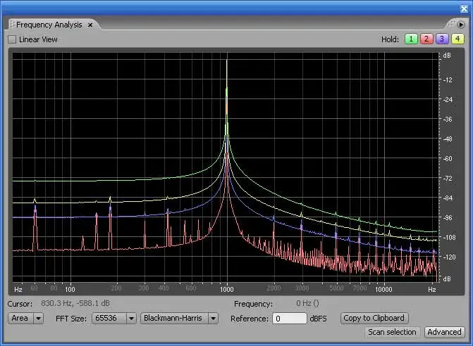

Audition has a pretty good FFT actually.
green = 0dBVU
yellow = +2dBVU
Purple = +4dBVU
red = +10dBVU
Is seems that, while noise is reduces.... THD is increased!
I think if I keep my board from getting much past +4dBVU, I'm OK.
And now it all holds true.
Maybe, maybe not. I'm assuming all the 1kHz peaks are normalized to 0dBFS. If so, you may just be seeing the reduction in noise, which was disguising the harmonic distortion.
Hmm, I see.

I get the same result. I think one thing you have discovered is that since your converter is 0dBFS = +16dBu, is that your gear is never going to be strained too much (it probably has another 6dB of headroom), and that distortion and noise shouldn't be a problem for you. And that is a good thing.
