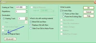

On the paste dialog, there's checkbox on down left corner to select Link to original clip(s)... Maybe it helps... :)
Jaymz

I've never used that Link to Original clips Jaymz. If I understand it right, any mods you make to the original clip are mirrored in the 'linked to' clips, which is not usually what I want.
