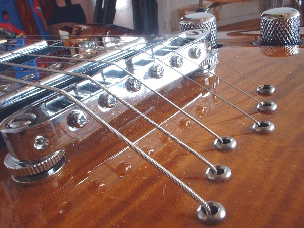

This is the kinda thing I was getting at with the bridge and stringing
http://images.epiphone.com.s3.amazo...er/1958-Korina-Flying-V/Gallery/KO_Splash.jpg
But not V shaped of having the strings exiting through a plate.
Cheers mate, that's exactly the sort of thing I had in mind.
