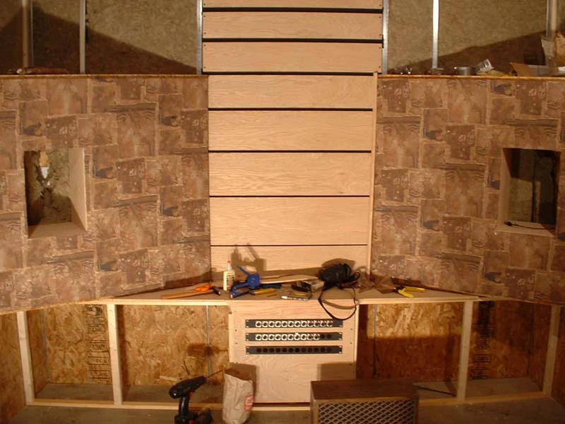

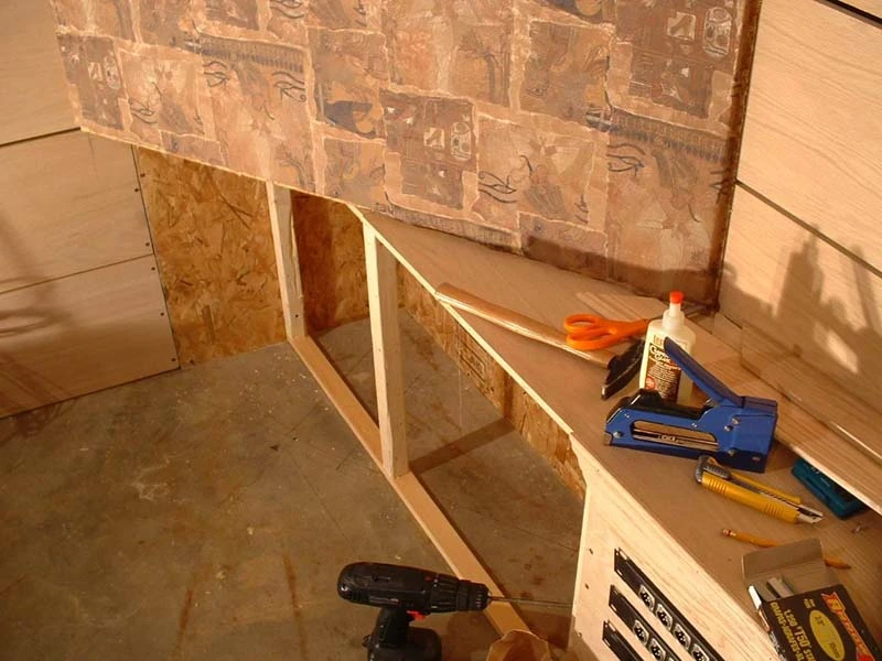

We're putting bass traps under the soffits, made from acoustic hangars. I figured it might be a good idea to continue those hangars all the way across the front of the room, making it one giant trap. You can see the start of the framework in this pic. YES, it will make a turn and continue flush with the soffits.
My main question is: Now that I've got this framework, it seems I have a shelf running between the two soffits (albeit a low one)... is this thing going to cause me problems acoustically?
