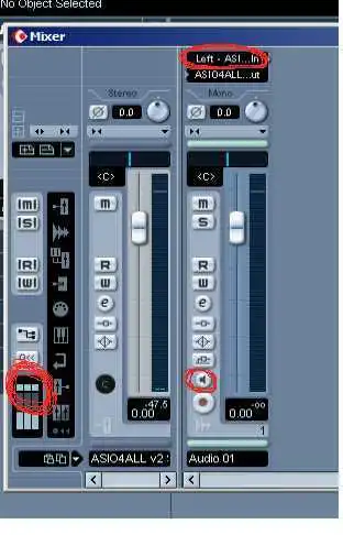

Go to the audio track you want to record on, and find the "i/o" section. (On the mixer view, its at the top) Then select the input bus on the Input section. Then arm the track. Hit record.
The bottom-left circle is where you can un-hide the different views of the mixer, just in case the "i/o" section. The top-right circle is where you select the input bus for that channel. If you want to monitor the input, then press the little speaker button (circled below as well).

Thanks for the reply, but we've been through all those options, I'm a Cubase SX user myself so could run through all the basics before getting stumped. To be honest, I think the problem is that I'm trying to help remotely - I reckon you've probably described the solution adaquately, and coupled with my advice on setting up busses, it should work. Like I say, this guy isn't very technically minded and may be hitting the wrong buttons - I think I'll have to lay out a help file with a bunch of screenshots like yours. I should charge.
